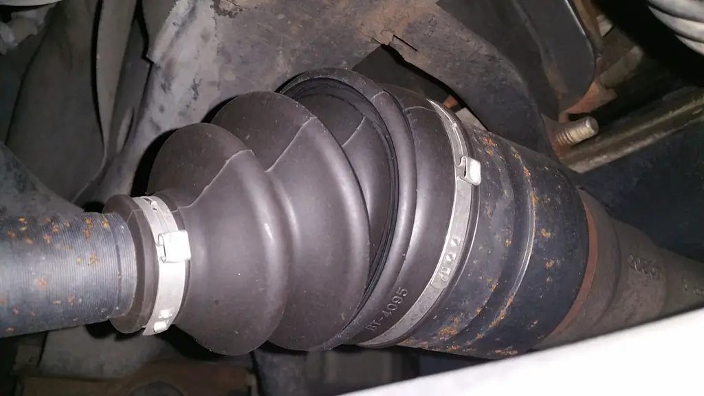

So Ive had my lift on for probably 3-4k total. I had the issue with the outer boots rubbing the bottom control arm. That was fixed by putting aftermarket c/v axles with smaller diameter boots on it. Problem solved.

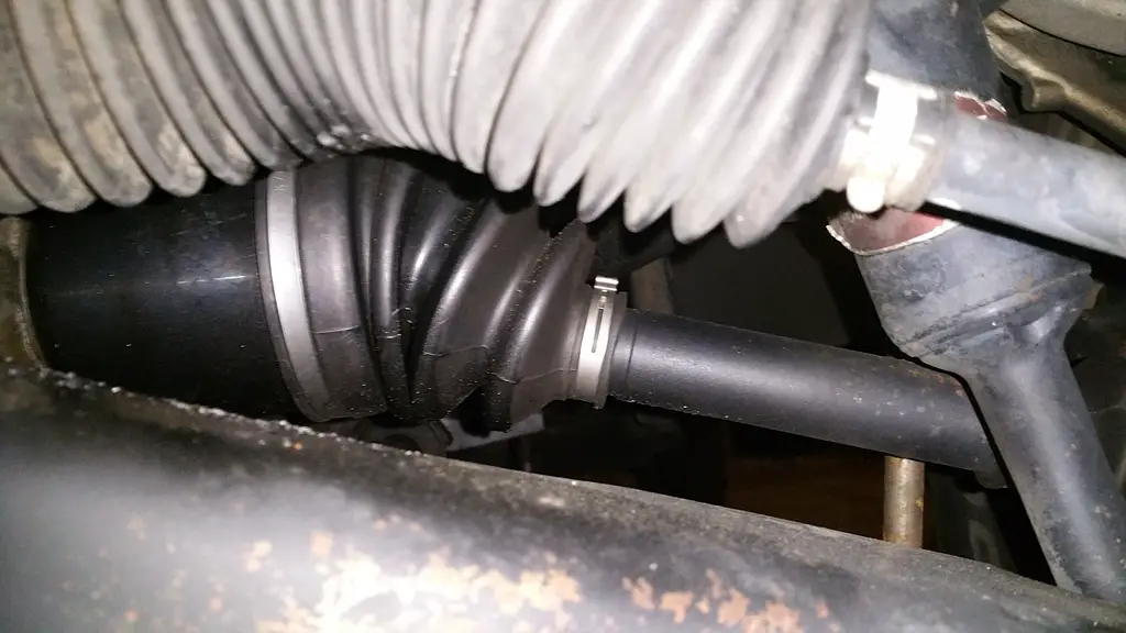

Now, after putting about 2k on it since that fix, the inner c/v boots have basically rubbed a hole around themselves because of the extreme angle they are at and are slinging grease. Anybody else had this problem? This lift has become more of a pain in the ass then anything really[c/v axles, vibration, etc]....and I dont really want to take it off. Im about to have to start driving it daily again so I wanna try to come up with a solution before I do. Id love to be able to drop the front axle in the frame but I dont think thats doable.
Well, there ya have it.
The extreme angle is the issue. Nothing you can do about it either.
dropping the axle would screw up the geometry of the front suspension and cause all kinds of steering, handling issues.
