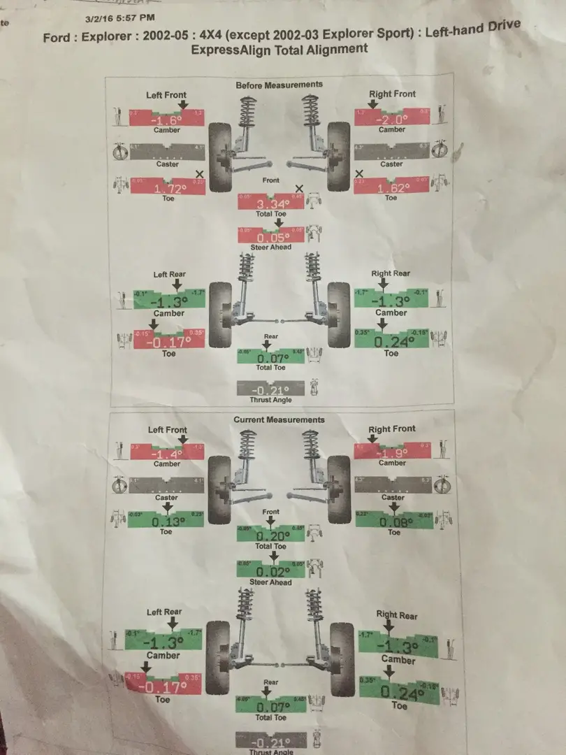

Top is before bottom is after
You can see how they were unable to adjust my camber because I was missing the "shims"
Hopefully I can fix this problem now :)
