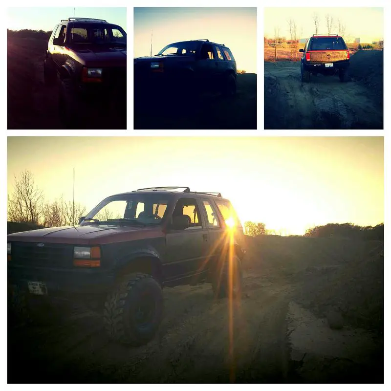

Playing around. In howell mi
Love it!! Nice work!!

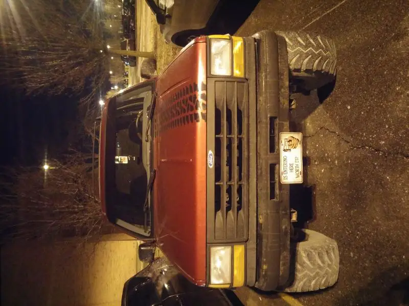

Also today i started my roof rack build i need a place for the spare tire when i get it along with a farm jack gas can and lights. Il post pics later when i get off work of the rack pre weld up and after. This is how she is looking today

How did you mount your roof rack and how sturdy is it

I started mounting it by making the feet. (Mind you everything I used was EMT conduit and junction box covers; everything you can find at your local hardware store or Home Depot.)
I used the existing roof mount track to hold it to the truck. I doubled strips of junction box cover that I had cut to fit in the track, tacked them together front and back, drilled a hole for the mounting bolt, and tacked a nut to the strip. I used 3/4" EMT (what I used for the cross braces and the outside rims...1/2" was used for the rest...) for the legs and pinched one end so it would fit in the track and welded that to the strips.
After that, all feet were notched to fit the rack for a good, uniform weld. To attach the feet to the rack, I placed the feet in the runners on the truck, covered the truck with cardboard, placed the rack on the feet so they were where they needed to be placed a couple tack welds on to keep the feet where they needed to be. After that, it was take the rack off, fully weld the joints, slide back into the runners and place the bolts in.
Seems like it wouldn't be the sturdiest thing, but I'm 165lbs and have walked, shaken and hopped around on it with no ill-effects so I'd say it's pretty sturdy.
