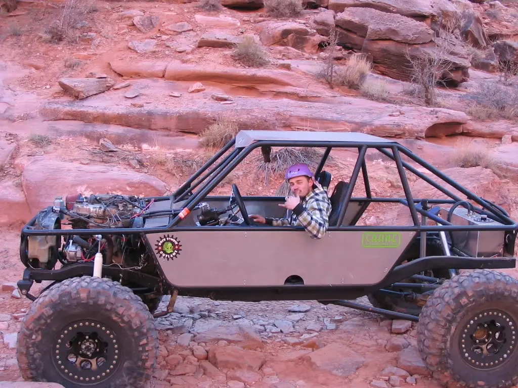

Hint -I like the lines of the F-Toy Chassis on Toyotas.
I like F-Toys a lot, so planning on doing something similar, gotta go wheeling new years day and then finish tearing body down, keeping the cowl panel with vin and some of floor.
Pic is example I stole from I-Net

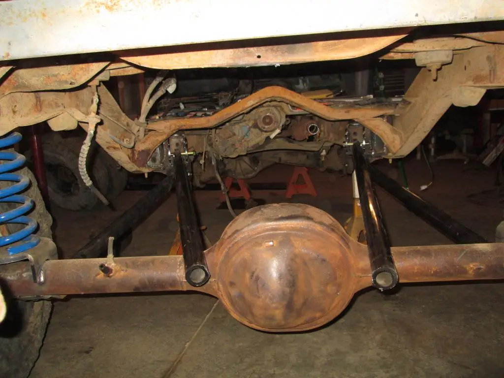

Finally had a chance to cut tabs of 9in, and almost finish stripping the rear, to prep for 4 link, cut front leaf spring mounts off today, weld up 4 link brackets, start to plate the frame and reinforce where the brackets go. Decide on amount of stretch. The good news is running fw 9in, no mods to rear of frame to fit coil bucket towers on outside of frame rail, plenty of tire clearance.

Picked up 100ft of 1.75 tube today, and some 1.75 .25 thick Dom for my upper rear 4 link bars, hoping to get 4 link all mocked up, it's getting close.

Working on 4 link this weekend, in-between baby naps and life. LOL slow going. Need to design truss and get upper links mounted.

Getting further, still need to pull axle out and finish welding, box the truss in.

I used 1/4 thick 7in tall plate to box frame in, goes little higher than top of the rail and at the bottom I but them so i could weld shut, and then my bracket would still slide under flush. Artec 4 link frame brackets. I also box the frame completely to help support the outer 7in plate. In front of the brackets will be used as a spot to tie into cage for more support.
