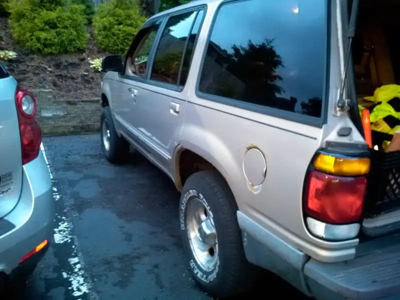

Here's a photo with all of the running boards & supports gone.
Much better, IMHO.
That does look better!!

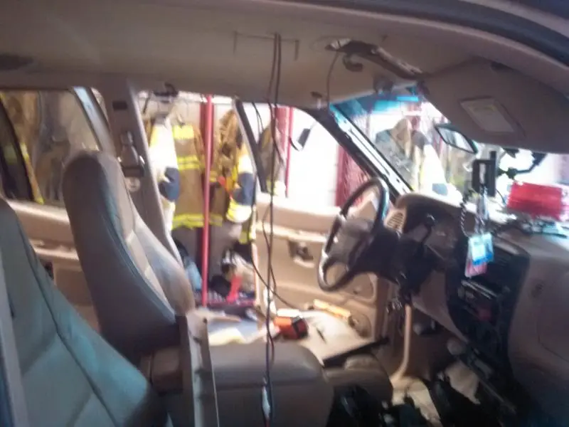

Time to start modifying the interior.

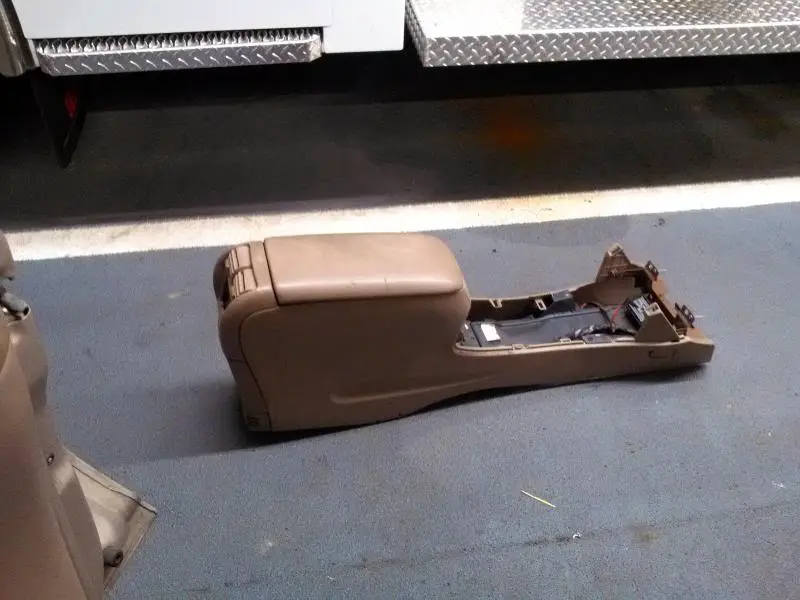

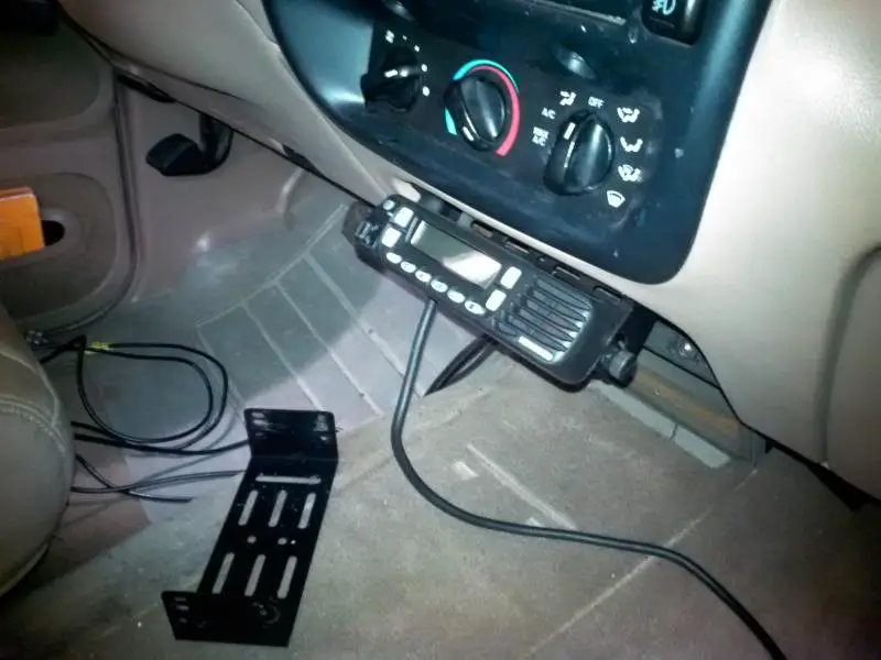

Removed the full-length console

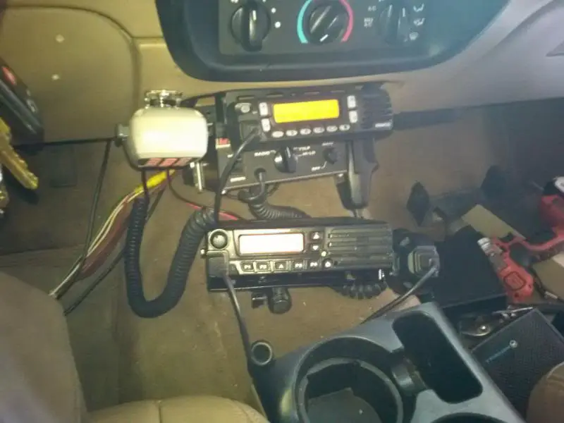

Added the remote head for the TK8180

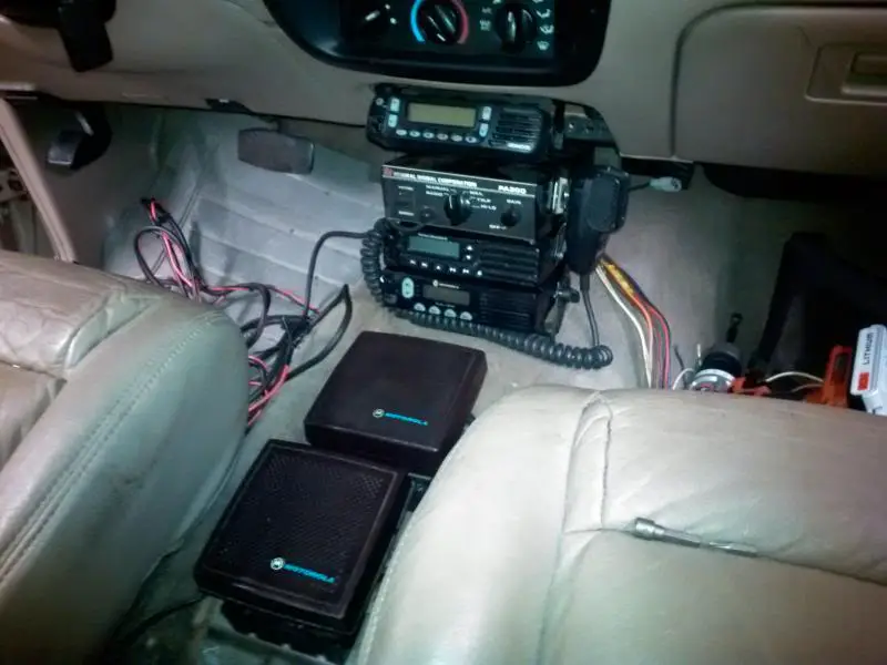

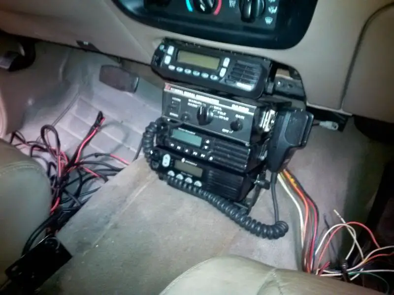

Stacked up a Motorola CM300, a Vertex VX4205, and a Federal Signal PA300 siren under it
Added a couple of extension speakers for now
how did you mount all that under the dash??
Are you going to shave down the armrest and put it back in ?

I mounted the CM300 to the floor on it's bracket, and then used small chunks of sheet metal with two holes to mount the rest of the equipment together.
I thought about modifying the original console.

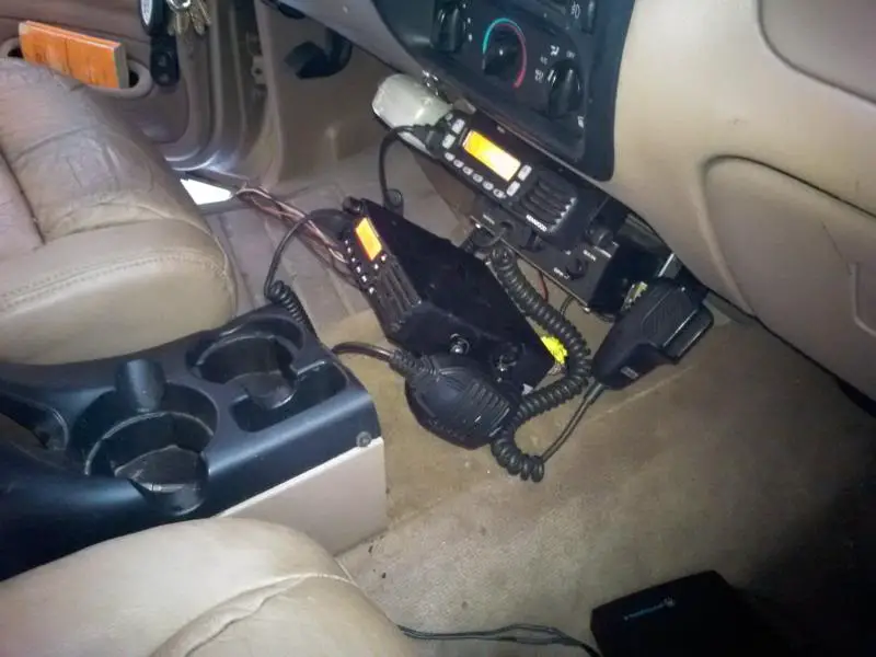

Re-did the center console today, cut off the front clean.
Decided I didn't need a second UHF radio, so I took out the CM300. I remounted the siren and VHF radio, to mesh with the modified console.

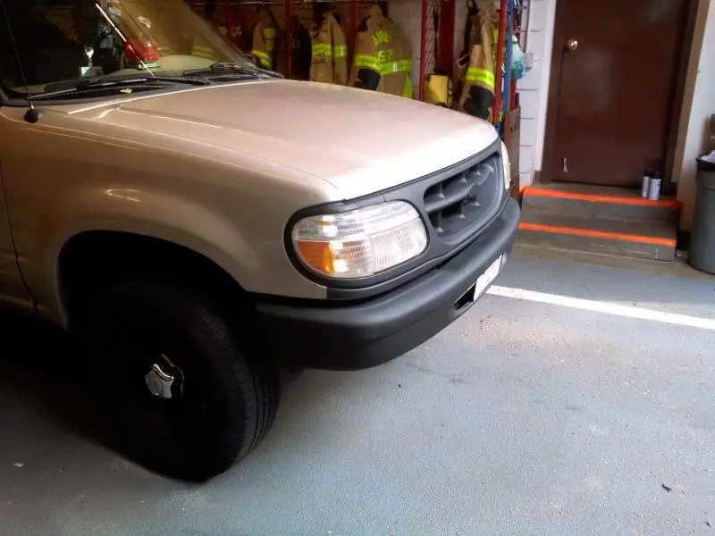

Just made another executive decision. Black is cool, but it's been done to death.
Skyforger will be Mandarin Copper Metallic when finished.
Oh man. Really? That's rough dude. Not trying to be a jerk, but why not something more emergency-response oriented? Red? White?
Yeah, red would be cool
I'm not sure why, but I've always hated red cars. White is also a no-go for me. I own a fleet of white service vehicles (an ambulance service).

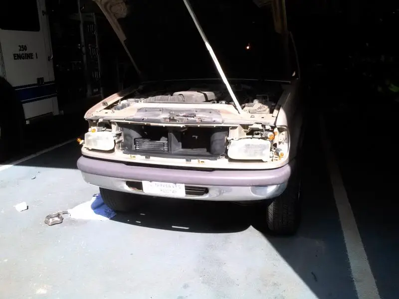

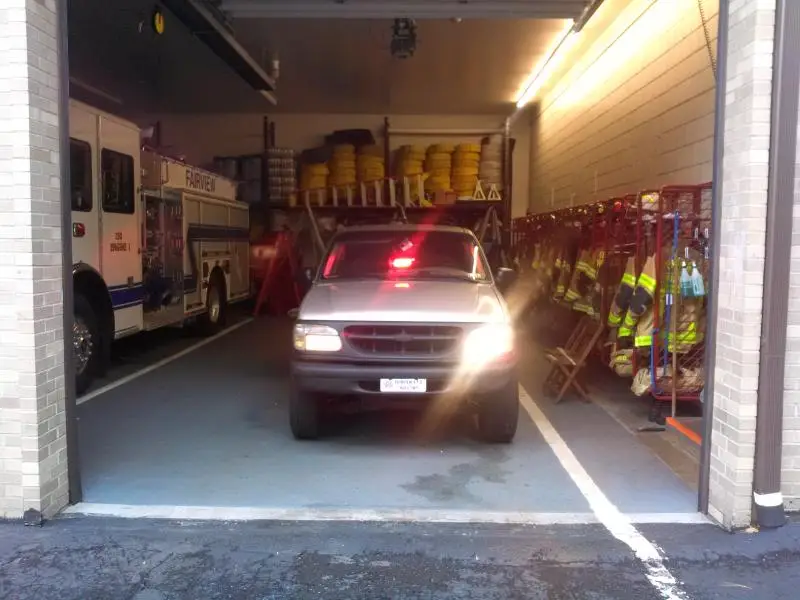

I got bored today with only a few resources at my disposal. No calls + bored Fire Policeman + Whiskey Dents + Rustoleum flat black =
You know, when I revamp the bodywork, I might just leave it that Safari Tan color.

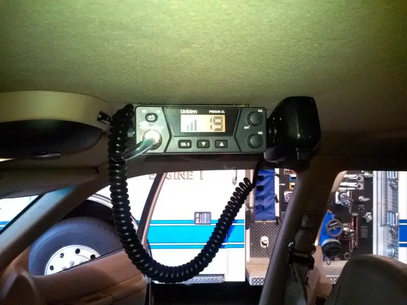

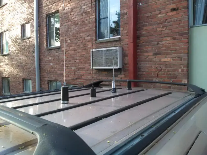

Started the day by installing my new CB.
Complete with new antenna:

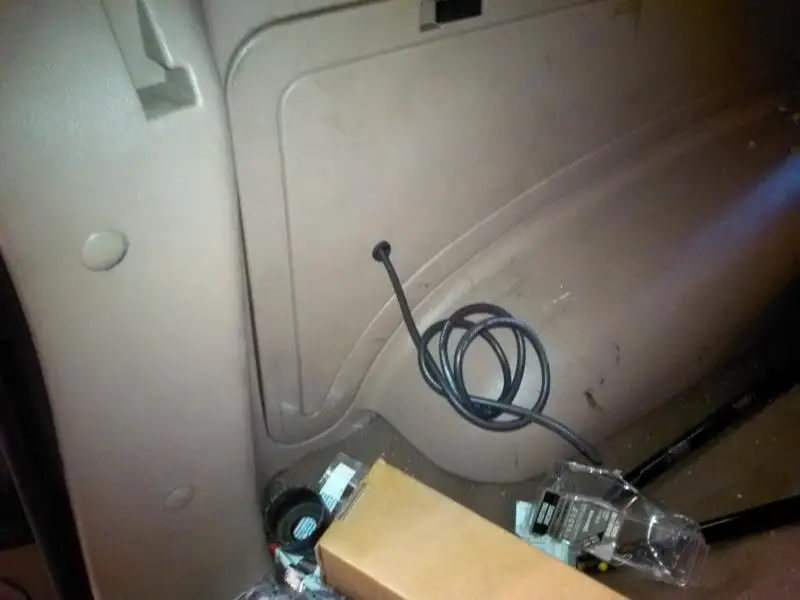

I began to install the wifi hotspot in the rear cargo area. I installed the 12VDC to 5VDC USB stepdown converters in the rear fenderwell, and ran the antenna coax out of the panel.

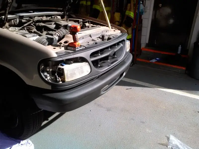

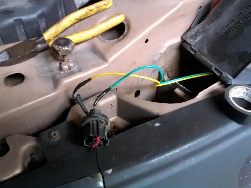

Installing the headlight flasher:
Warning setup still in progress
