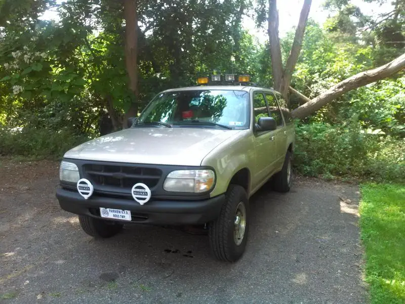

Added the fog and flood lights to the roof rack, and a set of driving lights on the front bumper today. They aren't wired yet.

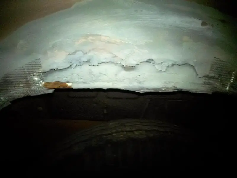

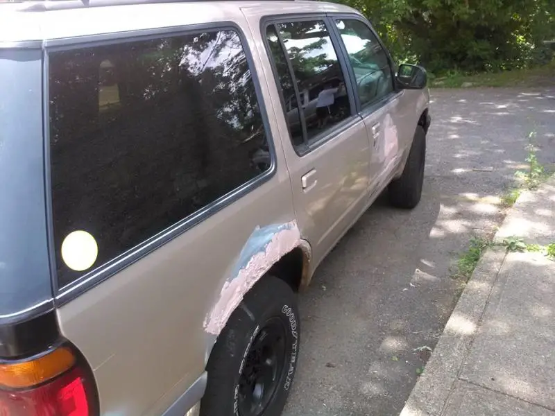

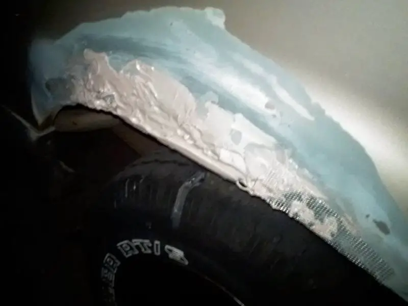

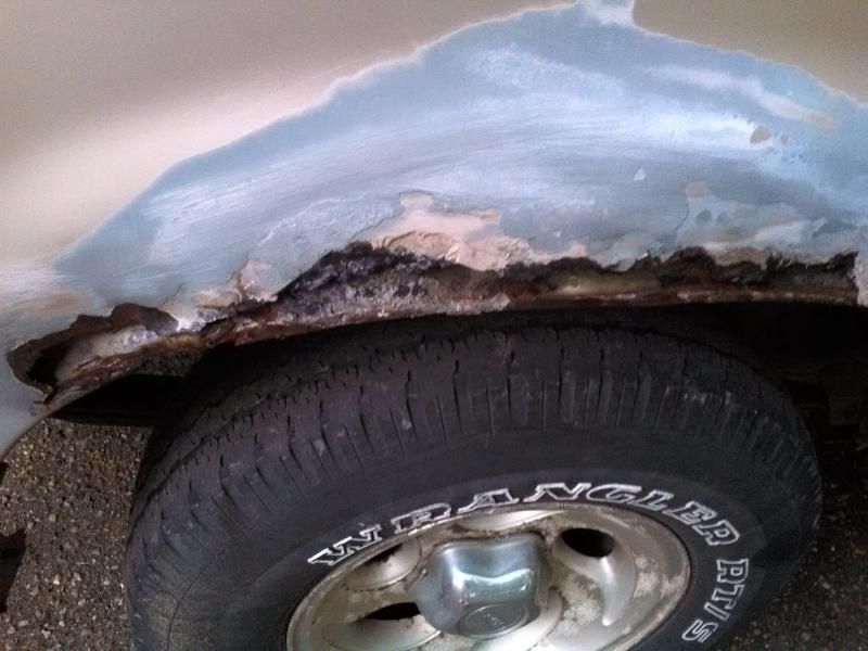

Started repairing that rusted-out fender tonight. I cut out the worst of the rust, coated the rest with multiple layers of rust reformer, then beat the edges of this mess inwards with a hammer. Afterwards, I patched the hole over with two chunks of screening, and formed up a chunk of sheet steel and riveted/screwed it into the hole. I then started laying coats of Bondo over the whole mess.
It looks like absolute garbage. However, when the sun comes up tomorrow, there will be much more skim-layering, sanding, and priming. And that makes me happy.

I pounded out as much of that sick passenger door whiskey dent as I could, and started sanding and filling that too

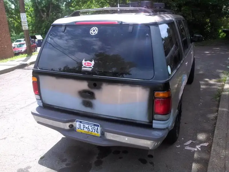

Side note - This thing has some rust in the most interesting of places.
On the photos of the liftgate above, you will see a rainbow staining coming from the metal buttons that attach the glass to their lift shocks. Those buttons had surface rust. I sanded them, coated them in rust reformer, masked them off, and painted them with 4 coats of satin black.

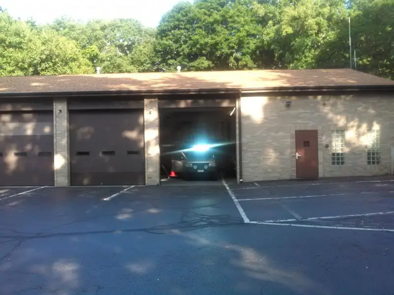

Blown away doesn't begin to describe this light.
Arrived, and properly mounted. I used self-tapping hex-head cap screws, and drilled a half-inch hole. Used a rubber grommet to run the wire through, and siliconed both sides of everything.

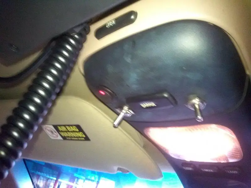

Next came some custom work to the overhead console -
And bright? Not even properly describing it. More like, there's another sun coming from my fire station.

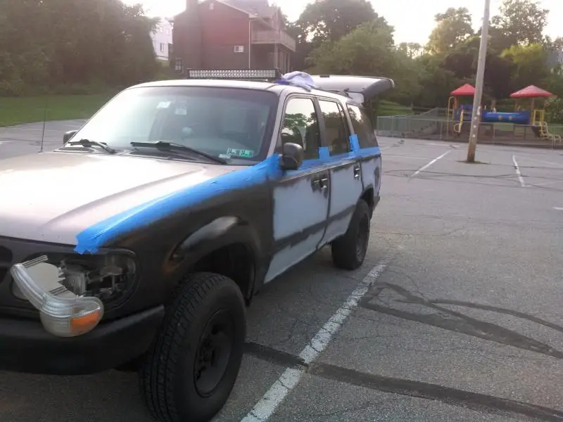

Sanded the Bondo flat as humanly possible on that passenger quarter panel.
Started the two-tone can job -

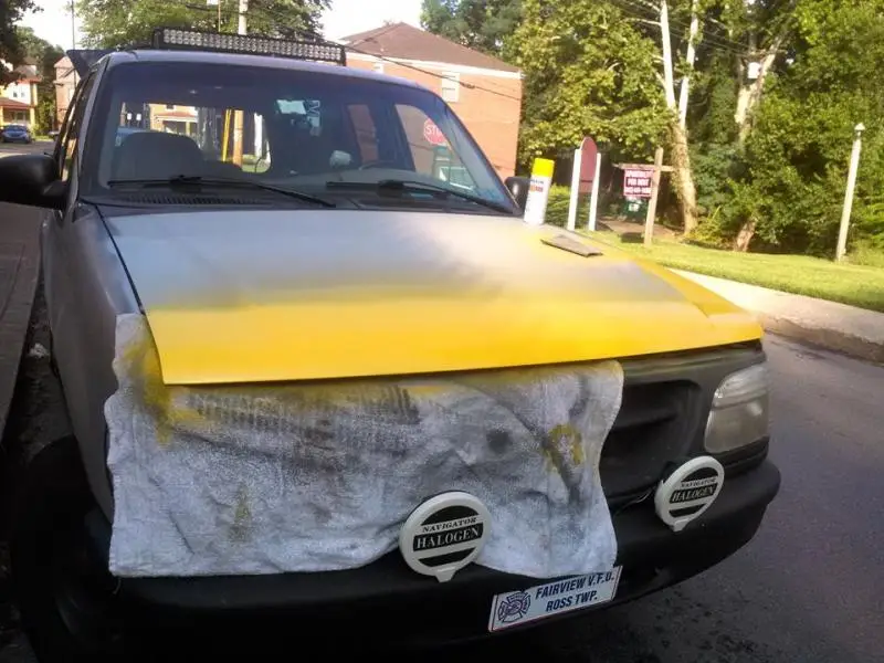

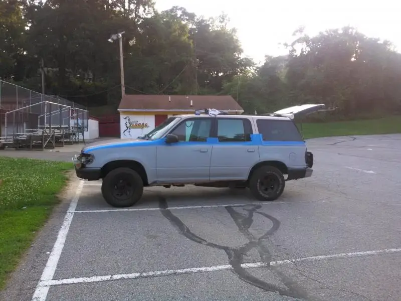

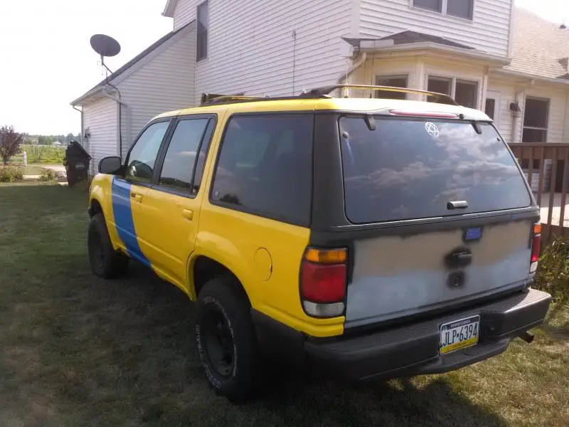

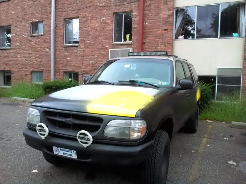

That black turned out really bad. After about a week on the truck, it was hazing horribly. I have started to experiment with many different ideas, and I found a winner.
A local trader supply is going out of business. They have the large cans of Rustoleum gloss enamel (1gal) for $12. 7747, Sunburst Yellow. Harbor Freight just opened in town. Can you say $50 paint sprayer? I can.

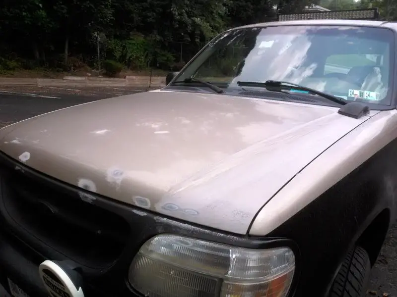

I sanded off the spots where rock chips in the hood were forming rust spots.
Then primered the whole thing (ran out of gray, so finished it with black)
Now, testing methods for the yellow
September 18, 2006
68
Bellevue, PA
97 XLT "Skyforger"

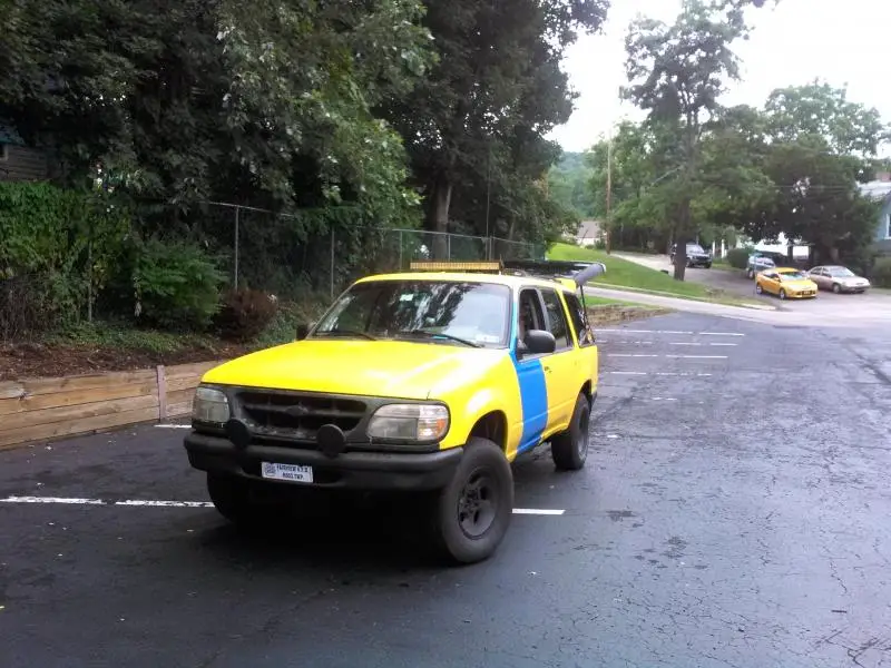

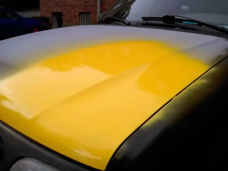

Moving right along. I figured out that the secret to factory-smooth glossy paint from a spray can is to sand whatever base you are painting with 400 grit Wetordry before layering multiple coats of gloss paint.

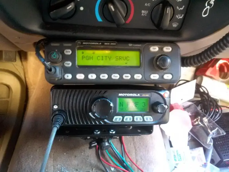

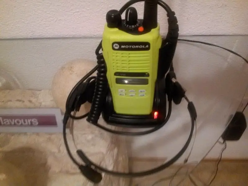

So, a little bit bogged down with work, but Whiskey Dents is good enough to be called Skyforger! I finished up the paint work, and have installed the NFPA 1905 chevrons (which I will photograph tomorrow). I swapped out all of the radio gear except for the CB with new radio gear.
Out with the old -
- Kenwood TK8180 UHF
- Vertex Standard VX4205 VHF
In with the new -
- Motorola XTL 1500 UHF
- Motorola MCS 2000 VHF
- Motorola MCS 2000 800MHz
Pictures:
I also re-cased my 2-meter portable and set it up for storm chasing, very easy and cheap.
