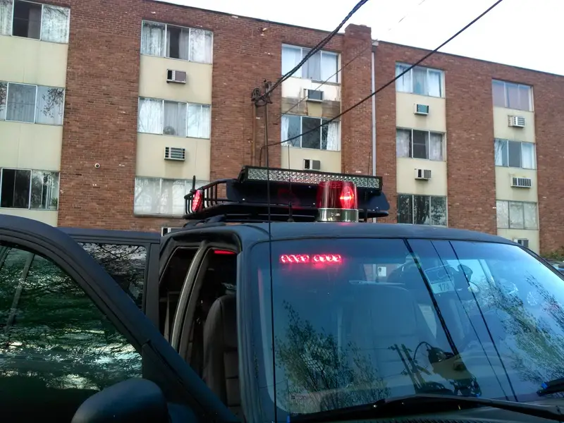

New photos of the completed roof rack/warning light install/antenna relocation project:
Wolo Power Beam beacon & Maxrad NMO 900MHz BMax antenna (used for scanner).
Custom Maxrad/Motorola hybrid NMO-mounted 800MHz gain antenna with spring.

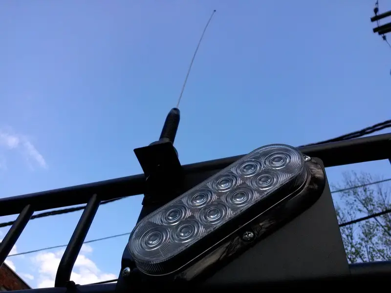

Elevated VHF antenna mount & LED warning light on passenger side of rack.
Elevated UHF antenna mount & LED warning light on driver side of rack.
Front & rear views of the new lighting, now active.
And with that, the roof project is complete!

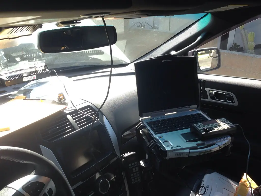

You were kinda close on the radio. It's a UHF S-split 450-520 XTS5000 in a XTVA with a W3 HHCH AND A 50. Watt amp. The radio is in the rear of the truck with 7 XTL5000 and two mobile repeaters. The W3 allowed me to control my XTS completely from the front seat then on a call out I grab it out of the XTVA and go with a full battery still waiting on my K9 partition that restricts my dogs movement to the rear passenger of the car so he doesn't slide around when I'm roiling code 3 ( it's kinda hard on the leather.
Laptop in the stand is a Motorola ML900 if you look in the passenger seat you'll see my old Toughbook CF30. It. Was time to upgrade
