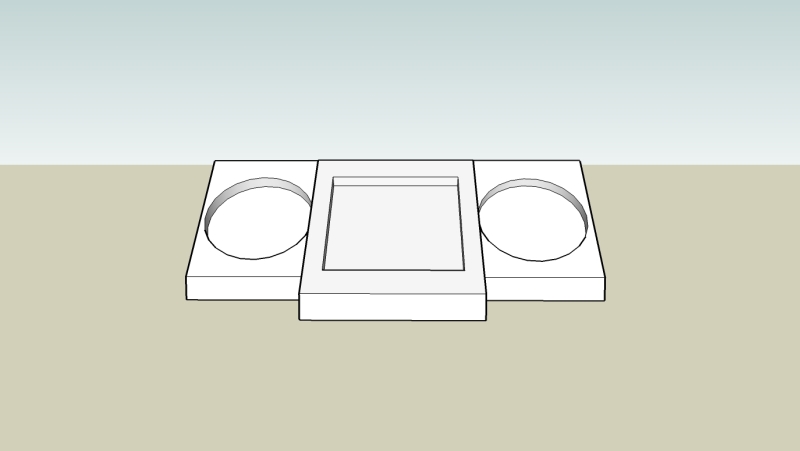

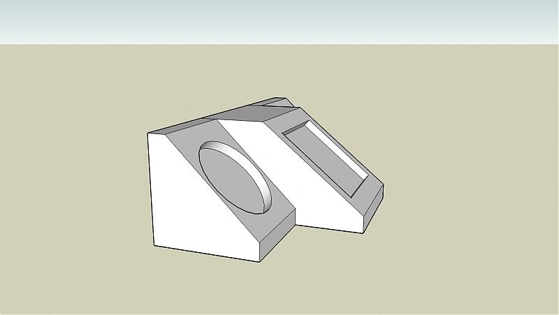

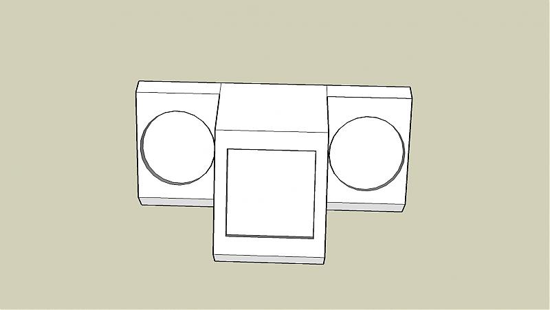

So I am going to step out and build my first box. Here is what I have - 2 10" subs (some MTX ones that I have from a previous build) and a 12" Kicker L7. I am running 2 Kicker amps - a 750.1 (to the L7) and a 700.5 (hooked up to my 4 door speakers and the 2 10"s). My current setup has all of this in it, just 2 boxes - which I absolutely hate.
Attached pics are a mock up of what I have in mind. I want to have the box fit under the cargo cover, so each box is 12" high.
The middle box is 1.94 ft^3. Kicker recommends .88 - 2.0 ft^3 for the sealed L7. The bottom of the box is 14x20. It has an 8" top, 2 inch rise on the front.
The sides are .74 ft^3. MTX recommends .6-1 ft^3. These bottom of these boxes are 12x11. The top is 2" and these also have a 2" rise.
Any thoughts?
