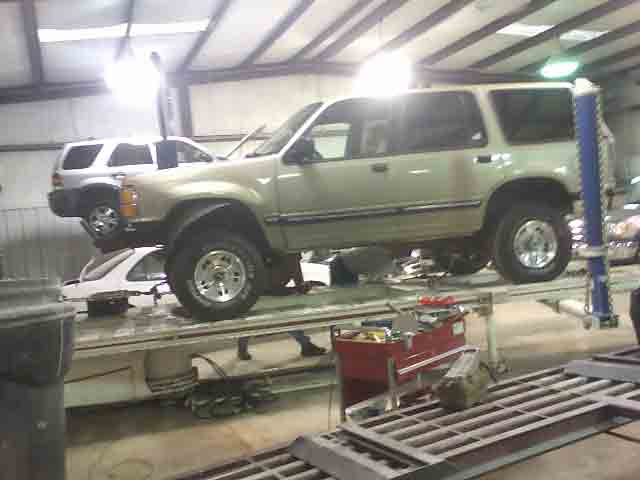

Thanks Froader i just got it back today and it was cheaper that i thought. the frame was twisted a bit but they got it all back in line. my radius arms, coils, and front bushings will be here tomm so hopefully i can start to get some work done.
this is it on the frame machine i took this monday. with my camera phone

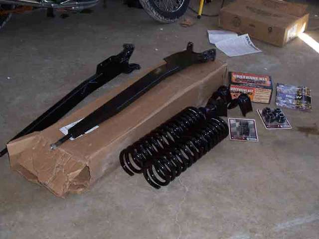

well today i walked in after school at one thirty and found three boxes in the garage. they are the coils, high performance urthane kit, and the radius arms.
all together
this was just neat to me
the radius arms are better than i first thought. they are mad very well and it all looks good. they are 12 inches longer that the stock radius arms for a 78 bronco/f-150. they are angled so the tires do not rub on a full cut of the front tires.
