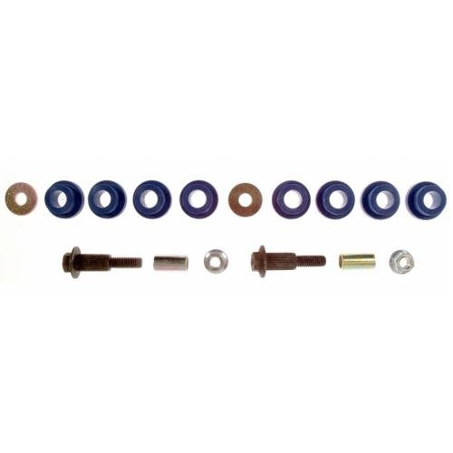

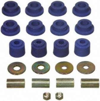

So I just had to replace my front sway bar bushings because one was completely destroyed when the previous owner had it... and I want to tackle the sway bar links (at least thats what I think they are) the bones connected directly to the sway bar....what exactly will it improve as I can clearly see some play in the bushings.... I'm only willing to do all the easy bushings as for harder jobs Ill leave to my mechanic once I figure out a good 4 or 5.5 inch (inexpensive) lift kit to buy.
will these bushings fit?
http://www.amazon.com/gp/product/B000C59ZMC/ref=ox_sc_act_title_1?ie=UTF8&psc=1&smid=ATVPDKIKX0DER
also whats a good inexpensive lift kit, I don't like how the 91 sits so low compared to the newer trucks... I will be off road 30% of the time
Those should work for the link bushings, if you replaced the sway bar bushings with the blue/purple Moogs as well.
You may also want to replace the rear bushings as well, the firmer poly bushings can give better handling than worn out factory rubber.

Thanks for the info... I'll order the bushings as I did replaced the sway bar bushings with moogs already.... it seems this kit has too many bushings
. I counted 4 sets total... if the top and bottoms are two pieces vs 1 piece... am I missing something?
As for the lift kits I saw a few online ranging from $650 to $850 since I'm new to this I'm not sure if these were decent inexpensive ones or straight garbage... they came in 4in and 5.5in kits
The bushing kit probably comes with those "extra" ones so it can fit more vehicles than just the Explorer, probably the Bronco II and a few other Fords. It's easier for Moog to just throw in 4 more bushings that let the kit work on several vehicles rather than having multiple kits, part numbers, etc.

I took the suggestion on doing the rear as well, I just want to make sure this is the correct kit before purchasing. It dont seem to have the sway bar bushings included and when I searched on moogs site it came up blank... this is weird... anybody have the part number for this??
Thanks again for the help!
http://www.amazon.com/Moog-K80085-Rear-Endlink-Repair/dp/B000C55ZW6/ref=sr_1_1?s=automotive&ie=UTF8&qid=1427553577&vehicle=1991-54-663-656--9-11-7-3469--8-2--138-1-0&sr=1-1&ymm=1991%3Aford%3Aexplorer&keywords=rear+sway+bar+bushings
