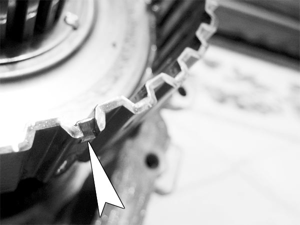

The clutch pack can only be placed one way - there are small little notches that must be lined up. Flip the clutch pack upside down and the notches wont line up.
Below is a picture showing one of the tabs that the notches must line up with

I I didnt even consider that the notches would prevent the clutch pack from facing the wrong way. I really should have caught that. :)

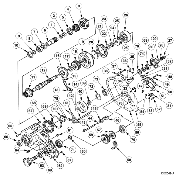

Wrench said:
IZwack - do you have an exploded view of the 4405 TC clutch assembly.
Ok here's an exploded diagram of the entire 4405 transfer case:

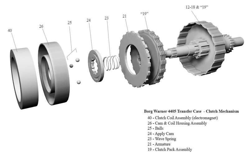

Okay I felt bad that that exploded diagram was too tiny so I modelled up the clutch assembly. I tried to use the same names as the ones Ford uses.
It's not too detailed so don't complain if there are two splines are missing on a part ;)

Thx's for taking the time to post the pic's
From looking at the diagrams the coil is energized to cause the cam to apply force against the clutch pack which inturn tranfers motion to the front driveshaft. A certain amount of slip is incured in the clutch unit when applying torque to the front drive unit in the auto setting depending on the amount of slip detected by the sensors between the rear and front driveshaft speed sensors. When no slip is detected then the clutch pack fiber disks spin freely between the steel discs due to the chain drive turning the whole unit all the time the rear drive shaft is rotating.
I certainly could see why these units fry due to an overheat condition if you were in slippery conditions and required the unit to work hard, the case only hold 1.5L of oil and no means of cooling.
