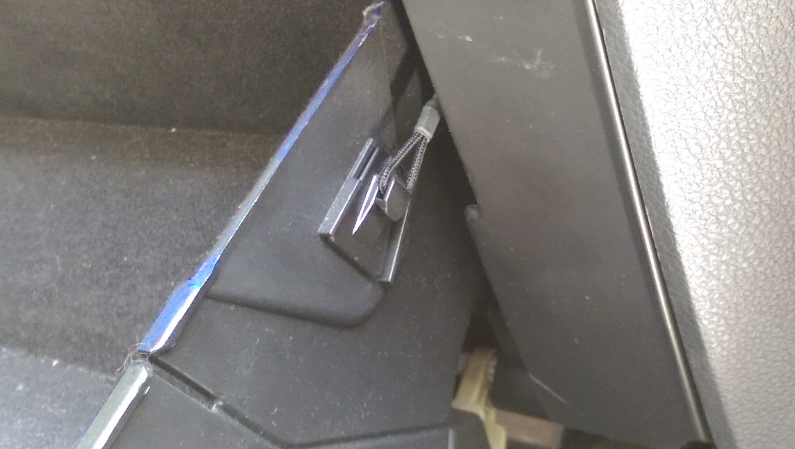

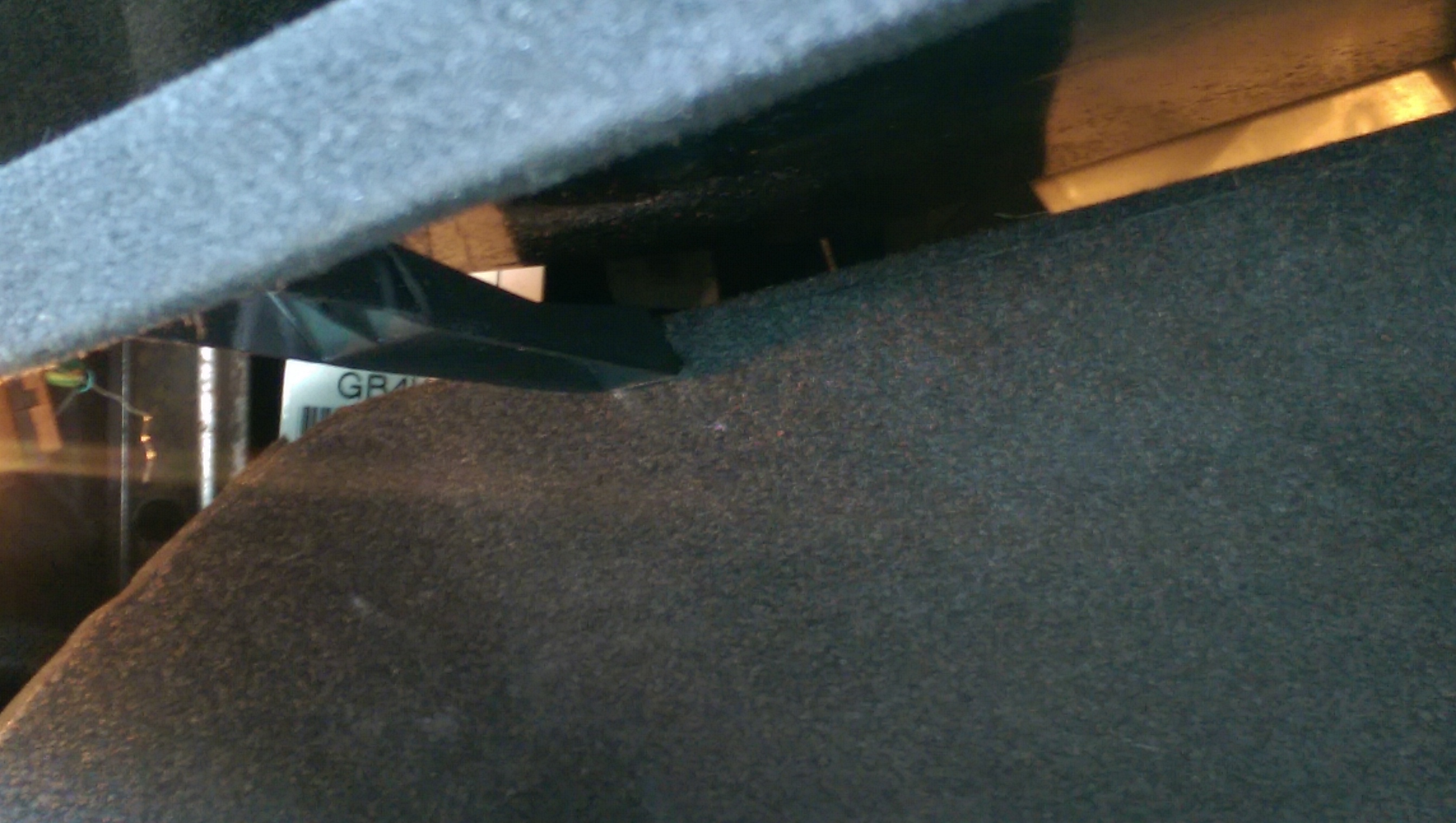

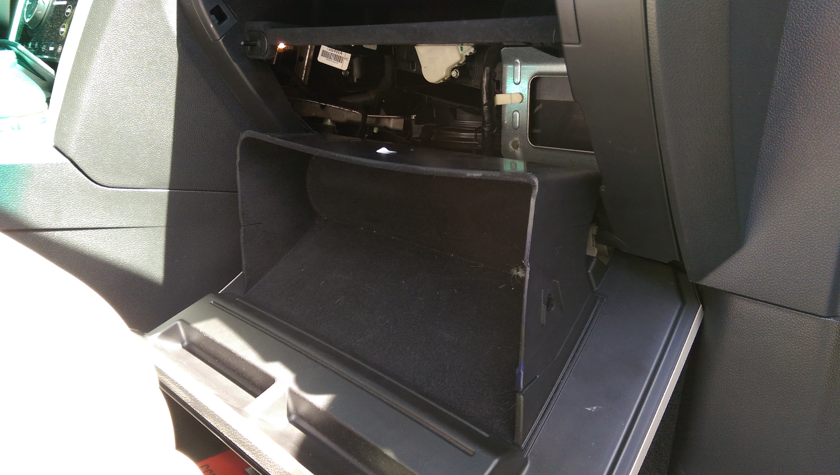

I had gone through this thread prior to changing my cabin filter and watched the video in Post #7. I have to say I think the video is making this easy fix more difficult for folks to do this job. I was able to do this without messing with the white clips or having to completely disconnect the glove box from the dash.
1) After clearing out my glove box, there are two fingers up high inside the glove box that limit how far it is allowed to drop. I pushed up on them gently to allow the back of the glove box to clear them.
2) This then allowed me easier access to the tether cord on the right side of the glove box. This easily disconnects by un-slotting the plastic hook that the string hooks into from the side of the glove box.
3) The glove box can then be lowered down to allow easy access to the cabin air filter.

Just replaced my cabin air filter. Yes, it is a pain in the butt removing the hinge pin closest to the passenger door, but it's required as the glove box doesn't lower enough like the pic in post #32. With the glovebox out of the way the filter was a breeze to change out. I reinstalled the glove box without the hinge pins, left those sitting in the glovebox. The hinge is secure enough without the pins. After 20 months and 35,000 KM the filter had only a few bits of debris.
