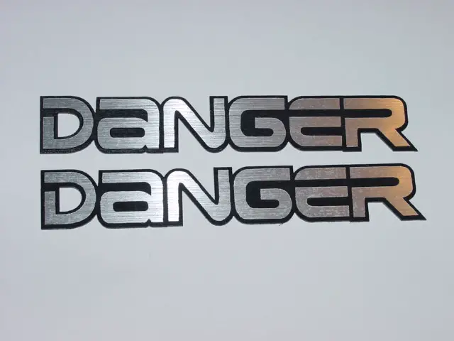

After all this, I had an epiphany. Why confine it to be a one off "ranger" when It can be anything.
Why not do something like this....
Any thoughts? Everytime I look at it I think, who shot JR (Ewing) lol. Sacrilegious?
Here come the Pinto jokes...
Then again, I could just leave the emblems as they are....huh

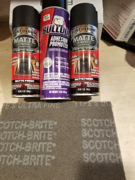

I want to paint some emblems. I believe they are chromed plastic.
I have the grey ultrafine scotch pads to scuff. Bulldog plastic adhesion promoter, rustoleum matte black, and 2 cans of single stage vista blue thats hasn't arrived yet.

What's the gloss on the vista blue?
Reason I ask is you have the matte black for the background color.
I would suggest a good final clear coating with uv protection over all of it. But... if you want 2 different glosses, that's not going to work too well.
I imagine all your paints are solvent based as well. If any are fast dry, they are a "hot" product. Plastics and hot paints don't play well. Acrylics work best.
The chrome plating on them is super thin, and can wrinkle with hot products. Test all your paints on something the same as your final product ahead of time, to see the reactions.
How are you planning to apply the two colors? Mask and spray each, one after the other? Spray black, then spray or brush the blue?

The vista blue is a single stage so my understanding is it doesnt require a clear coat. I didnt order any clear but I might. I believe I'm working with acrylic enamels, but yes I'm concerned about melting plastic and using the wrong kinds of paint. Live and learn I guess...
Heres my plan. Scuff it, clean with isopropyl n water. Once dry I'll hit it with a couple coats of plastic adhesion. Then I'll knock down any nibs and do a couple coats of the matte black. I'll let it completely cure over night so when I put on the tape it wont pull up the paint when I remove it. I'll lay the tape over the letters and cut them out with an exacto knife, then spray a couple coats of the blue and cross my fingers. Lol.

I'm going to say you have messed around with automotive paints before using terms like "Nibs". Most don't know what that is. lol This is a good thing.
You got this covered for the most part.
The scuffing, cleaning, and de-greasing is a good idea. Same for the adhesion promoter. After the promoter, I would put on a primer coat, before the color topcoats tho. Not saying you have to use a primer, but it would work the best for the long haul. A final clear coat would also ensure the longevity of the paint job's aesthetics. When you clean them, you will be cleaning the clear, not the color paint. When something brushes against them, it's the clear that takes the damage.
I don't know what single stage your using. I only know of two part urethane single stage paint. In a normal HVLP automotive application, it doesn't need a clear coat. It gets it's shine from a good cut & buff, then a polish/wax. You said "Cans" of it, so I assume it's a two part spray can like Eastwood has.
Eastwood has some great two part paints in a spray can. From engine paint to detail paint, and clear coats with UV protection. These spray just like a spray gun, and are simple to use with a professional result. All that goodness in one package, does come with a premium tho. They are not cheap compared to everyday spray bombs. I know it's too late, as you already have the product, but check it out, and if what you have doesn't work out, this product will definitely work for your application.
Eastwood 2K Aerosol Paint - Automotive Aerosol Paint
Masking.... always the fun part. Masking detail work is an art form that takes patience, and skills. The people who make a living doing it are amazing to watch. I always remind people of this when they get frustrated masking. Doesn't matter how long it takes you, your day job pays the bills, not this stuff. Have a beer, take a break, come back later, and try again. But bring the beer too. Just in case.
Let the blue cure good and long before you pull tape, and be mindful of the edges, as paint tends to build up more there next to the tape. If you suspect the edges to have a thicker build, let it sit longer. A Hair dryer will also help by running it around the tape edges for a minute before you pull.
Well, that's all I got for you good sir. If you already knew all this stuff, awesome, go have one of those beers I told you to bring along, and git er done.

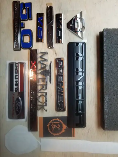

Its here!!! Its here!!!
Now I just need to order a case of courage and a packet of determination. Lol. If anything jumps out at ya let me know, I can arrange them and snap a pic. I'll be attempting arts n crafts this weekend.

and to think I had to buy the whole truck to get the emblems! LOL
Can't wait to see what you come up with
Premier badge? Wowee!!

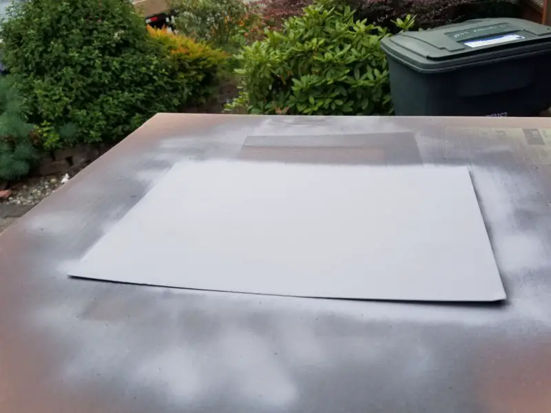

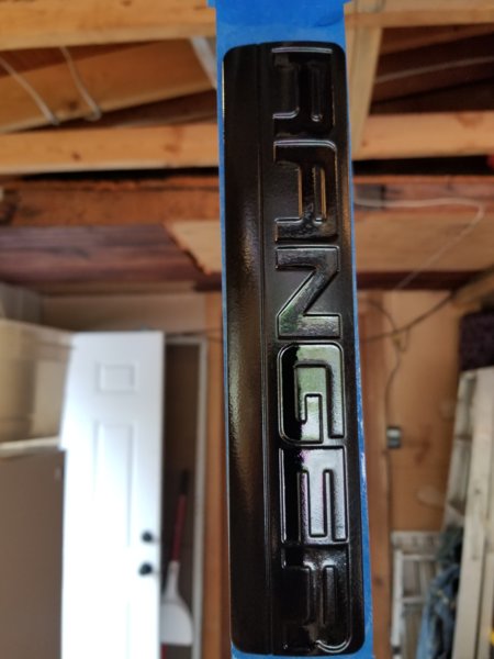

I lightly scuffed the emblems and a flash card, washed them with dawn, then a 50/50 water n alcohol mix. After drying I hung the emblems and applied 3 coats of plastic adhesion waiting 30min or more between coats. I'm new to this so I may have put it on too thick on the smaller emblems. It comes out of the can like wd40. Not much fan at all. I'm happy with the big emblem but the smaller 2 I'm going to let set overnight and try and smooth down the heavy spots before I prime them. I know itll be hard to see but everyone loves pictures!
The flash card was being a pain as well. The primer I started with ran out before I could get one good wet coat. When I went to get more the sun moved in and kinda cooked it. I tried to smooth it out and get one good wet coat. I'll let it set overnight as well. I'm painting this vista blue so I can visualize better.
I need to get some sandpaper because the stuff I have now isnt cutting it.

3m sanding sponges work great for detailed stuff, and come in a lot of grits. Most big box stores sell them in the paint aisles.
You might have better luck laying them flat to spray. Place them on top of something, like small dowel rods to keep the edges off the base. No runs this way, and the paint mills will be the same overall.

The wet coat on the flash card laid flat with only one imperfection where it might not have been completely dry. I like it, I'll give it a lite scuff then another wet coat and proceed to the single stage vista blue.
The big black emblem looks good but the smaller 2 might not be plastic or the chrome coating may need to be completely removed. I tried to smoothe them out last night and most of the plastic adhesion cam off so I just removed it everywhere but the letters. I'm going to hit them all with the primer and see what sticks!!!
@gmanpaint
I'm using those 3m pads you referenced. I hung the emblems because it reduced the amount of flat surface for dust to settle. I dont have anywhere clean to paint. Im glad I stopped yesterday because I'm so impatient. I would have just kept layering the paints and it would have been a disaster.
