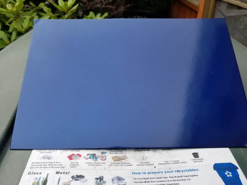

While I was replying to your question about recoat times and staring at the flash card I started to wonder if it was dark because I was seeing the black primer through the paint. So I wiped it down and added another coat to the flash card and one coat of matte black to the smaller emblems.
I have to say this single stage works great. It has a nice fan when applying, and it lays down flat. It makes me feel like a pro, If only you could get bodywork in a can!!! The flash card I painted was pretty hammered before I painted it. You can see dings, dent, divits, and scratches in it but almost no orange peel!! Just like my truck, it's super hard to take a picture because it's so shiny and reflective.
I think I'm done with the flash card... but I added a 3rd coat any way. I could experiment with a clear coat but....i read that you can still clear coat singlestage paint but it's not necessary so i might not.

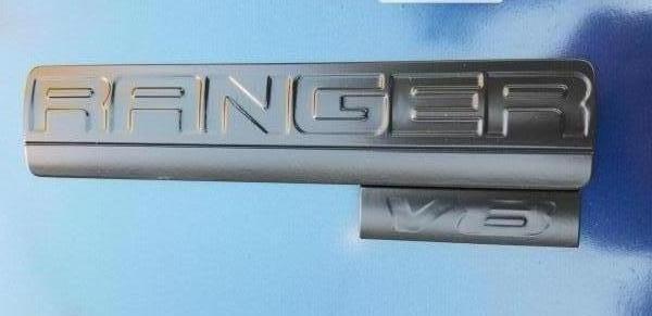

I added the first coat of matte clear coat to the 2 smaller emblems. First coat is drying.

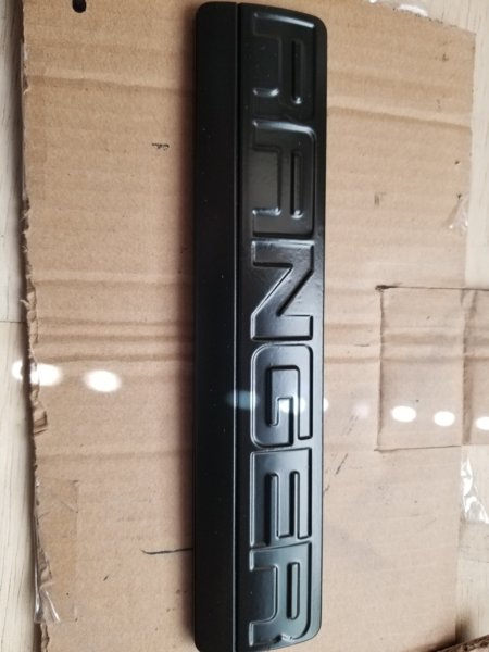

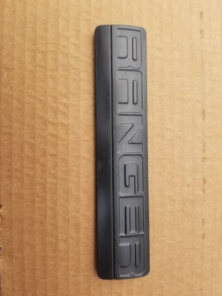

The big one set enough, I opted to just scuff n repaint matte black. Pictured scuffed.
It's been repainted and waiting to be clear coated.

Heres how the flash card turned out.

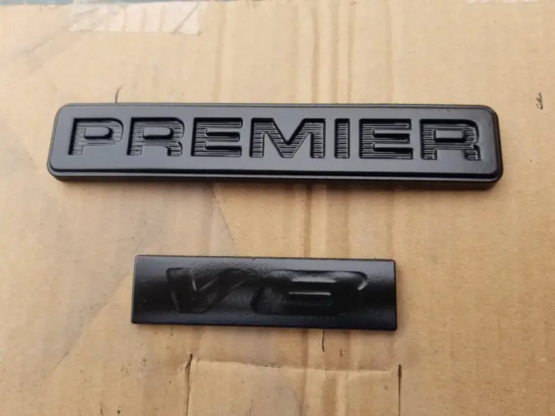

Here are the emblems after 2 coats of matte clear coat.
Only issue with these so far was a couple tiny bubbles on the premier emblem after the first coat of clear. I popped them with a razor and smoothed them out with my fingernail. The big emblem turned out ok and is curing with the others. They will need to set overnight so I can mask and trim out the letters without wrecking or pulling up the matte black.

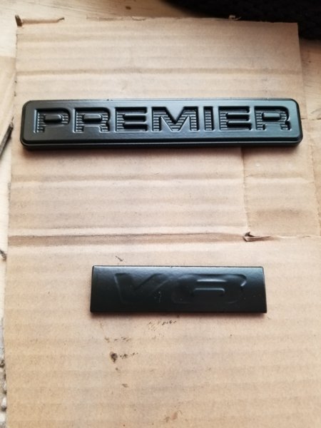

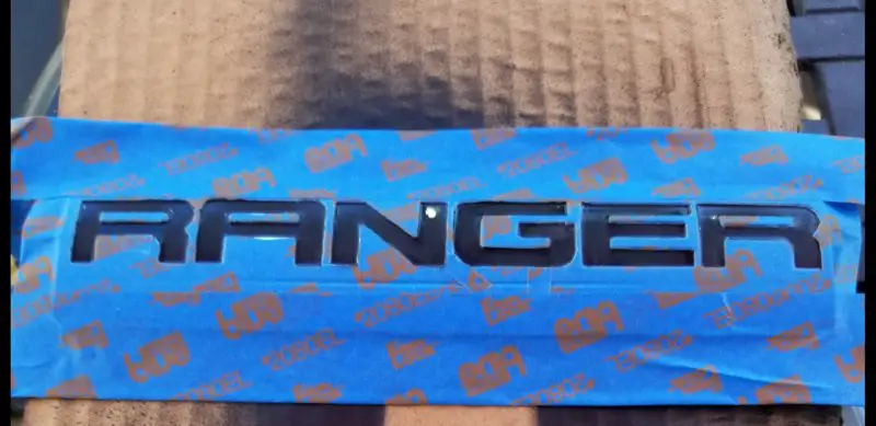

Emblems before taping
After taping.
This will be a pain!! I scuffed the big one but I only used a tack cloth on the other 2 because I was afraid of messing up my somewhat half assed tape job with my 50/50 alcohol water mix.
The purple hue is from the umbrella above. This is the second coat. I'll hit this with a crystal clear coat after I'm certain they are well covered. I had a chip in the letter N that I forgot to hit with primer so I cheated and used a black permanent marker. Lol. Shiny chrome chip dissapeared but you can see the rough edges still.

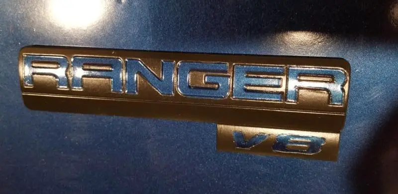

Im happy to report no bad reaction from the matte clear coat and the single stage urethane. Once I taped the emblems I just used the tack cloth. No scuffing and no 50/50 water alcohol. The letters are recesed so I didnt think there was much chance of contamination from handling. I was REALLY surprised the blue was as visible as it is. I expected it to disappear. I did not add any clear coat to the vista blue.

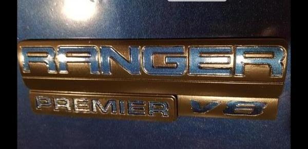

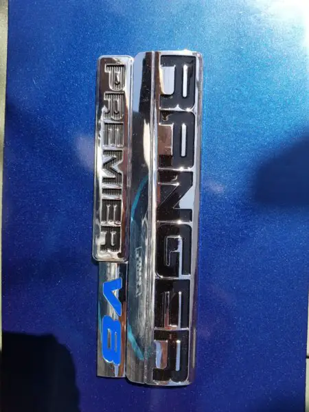

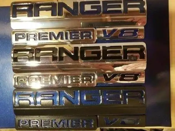

Now, with out further adew....what we've all been waiting for..... drum roll please......
Introducing the proto types
Jumbo jumble

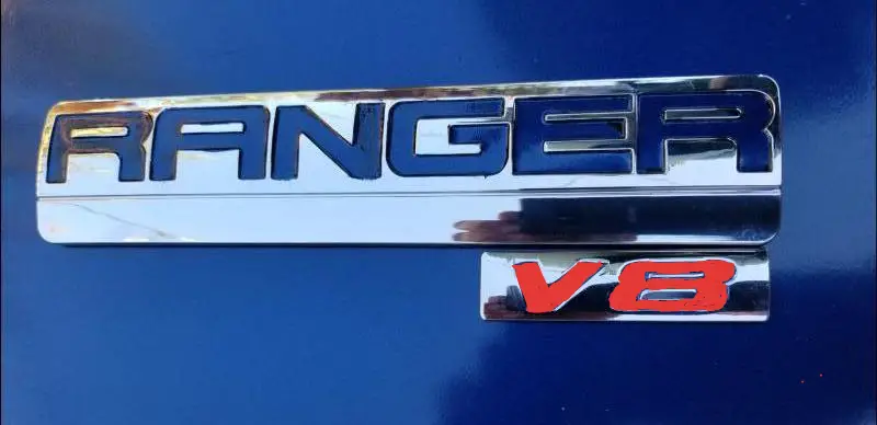

Chrome n black Ranger V8
Chrome n black Ranger Premier V8
Blackout Ranger V8
Blackout Ranger Premier V8
Chrome n blue Ranger V8
Chrome n blue Ranger Premier V8
Chrome n blue Ranger red V8 by request
Black n blue Ranger V8
Black n blue Ranger Premier V8

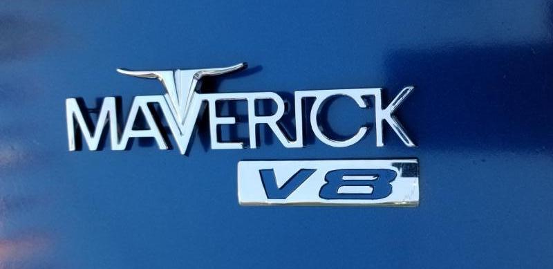

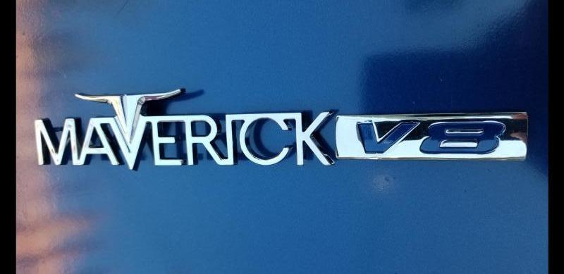

Maverick V8
Maverick V8 long
@410Fortune
I'll make a blue n black set as soon as I can. I may like that the best. Im still liking the maverick, the definition of a maverick fits the truck but I'm not ready to commit to it yet.
Maverick definition: unbranded, individualistic, non conformist, etc...

It is hard to get good pictures on the flat. I can try n get better shots of all except the blackout set as it's now the black n blue set. But if anyone wants a better pic just let me know which one or what set and I'll see what I can do.
These are proto types and I'm not a painter. These were created to help visualize. Thanks for lookin!!!
