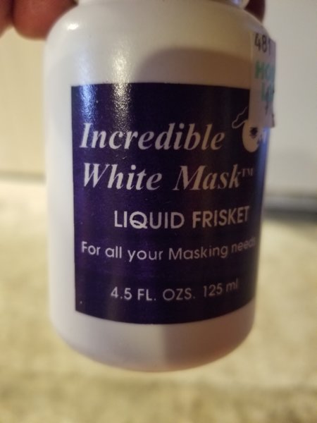

Found this Gonna give it a try. Incredible white mask liquid frisket.
Ofcourse after bringing it home and looking up how to use it, turns out its basically liquid latex( which I had already for Halloween makeup. Also read that model hobbyists use diluted Elmer's because it's cheaper. Well let's see how it turns out!!

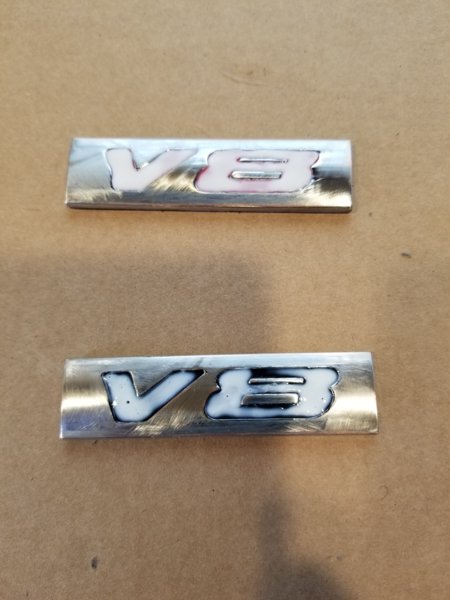

Back at it!!
Started by scuffing the 3 emblems with 400grit.
Cleaned and applied frisket mask to the places I didnt want paint.
I think I got the hang of the frisket mask by the end of the 3rd emblem. You need to finish each letter before it starts to set otherwise it will attach to the brush and start stinging up. I found it was better to push the frisket into the tight corners. I've never used this or attempted this before.
I let the frisket dry then applied 2 coats of bulldog plastic adhesion. It was 66°f and overcast. I waited 30 between coats.
Used up the last of my grey primer and let set 45min
Sprayed a 2nd coat with black primer.

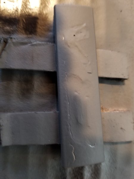

Then this started appearing. Not sure what's causing it but I'm holding up here and letting it cure enough to sand. I'm undecided when to remove the frisket. I'm not sure if it's better to remove it while the primers still soft so it doesnt skin over or wait till its cured so I dont lift it???? Anybody???

To me it looks like the paint is too thick.
Some paints have a window of time to apply another coat. If not done in that window, you need to wait like 24 hours, scuff, then coat it again. It's because they are volatile based, and will eggshell, crack, etc... the previous coat. What's the can say?
Never used that frisket stuff, so can't help there. If in doubt, pull it off, and sand the rest, then start over.
Probably replied too late, as I just seen your post. Email notifications aren't working for me for some reason.

too much primer!
I am not sure I have ever used a primer on plastic bits after the adhesion promoter?
What do the instructions on the adhesion promoter say?

Slow or fast dry paints dictate the base coat type. The fast dry paints are Hot, and need a base coat that can withstand the solvents in them.
Promoter is just there to give a bonding surface for the paints. It's not a primer. Paints that are not "Hot" based, can be applied directly over the promoter, like rattle can acrylics made for plastics, or slow dry enamels. Acrylics are fast dry, but there are different base types of acrylics. This type can be very confusing because of that.
2k Urethane paints are hot, and need a base that can handle the solvent's, and why primer is suggested. Single stage paint uses either self etching, or epoxy primers, but is made for metal application normally. Primers can also be Hot, and need a surface that won't give to their solvents.
Random stuff to consider when spray painting....
The windows given are because they need to be re-coated before the previous coat has fully dried, and still has solvents in it. Once enough solvent has gassed out, it can be damaged by the next coat as the new solvent eats into it. Cure time and dwell time are also terms used. 2k paints can take 30 days to gas out fully, and is the cure time. Rule of thumb here is if you can smell it, it's still curing. "To the touch" term just means the top has skinned over, but underneath is still wet and still drying. Tacky means just that, it's sticky but doesn't lift and leave paint on your finger, and soft enough to leave a print mark.
Fun fact... Some paint's dry by osmosis. 2 part industrial epoxy, and lacquers dry this way. If applied during high humidity, the water vapor in the air will be sucked in as it out gasses, being trapped under the surface. This is called Blushing. Blushing leaves a white foggy appearance in lacquer coats, and a yellowing appearance in epoxy. Both can be fixed by applying a hot solvent approved for thinning the paint. It opens up the surface and as it dries, it pulls the water vapor out with it, and as the surface dries again, it seals it back up as the vapor exits. No more Blushing.

Well ya see the problem started when I picked up a can. Lol
Yes, yes, and more yes to both of you. I rushed from the get go. My intention was to get the primer on and peel off the frisket before the PAP and primer skinned over because Its the first time I've used it. I was also concerned about recoating before they were totally dry and finishing before the temperature dropped because it gets colder earlier now.
So here's what I did wrong, I probably didnt let the frisket dry completely first. Second, the PAP has a flex agent and I didnt let it gas off. Previously i waited 2 hours vs 30min this time. Can says I can apply a base coat 15min after the 3rd coat, I only did 2 coats. 3rd thing I did wrong was use rustoleum, it has a been known to do this according to lots of threads online due to it being a "hot" paint. So when I applied the second coat of primer it really began to shrink and crack.
A good painter learns from his mistakes by fixing them, I'm learning volumes!!! Lol.
It was good that I stopped when I did. I decided to let them cure a full 48 hours before I try to remove the frisket to see how well that stuff works. Might as well experiment...
