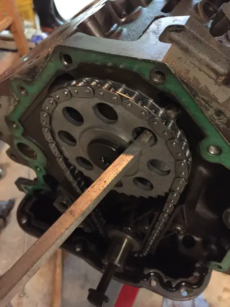

Looking at pictures can you stick a big screw driver through the sprocket into the block to kinda lock the sprocket from rotating. I would try something like that..
That did it. I've done that before, don't know why it didn't come to mind.
Picture below is reassembled, just showing where I placed the screw driver. Opposite side to torque it down.

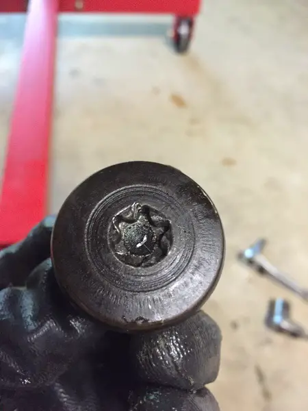

iPhone names the pix the same, have to post separately.
Bolt is boogered up, think I'll get a new one. The Torx bit hole isn't very deep.

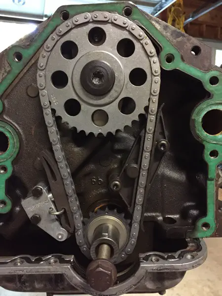

Couldn't replace the guide without removing the cam gear.
All back together, just not torqued down. Anyone use like a blue loctite on the bolts? I've not, just torqued to specs. But I hold blue loctite as a close friend.
