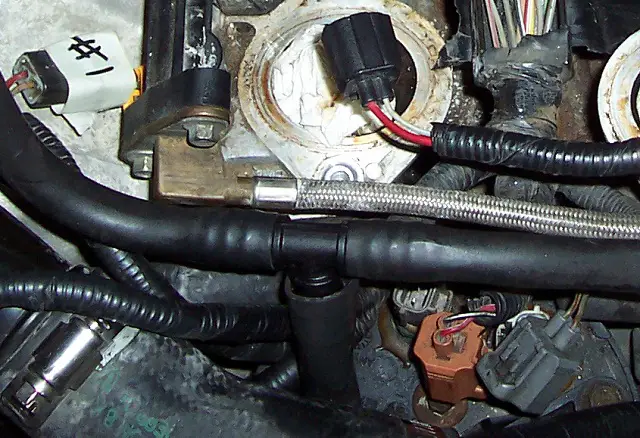

I've been working around this part for years and constantly repairing it. This time I'll be replacing the thermostat housing again because the bottom blew out of the one I replaced two years ago. The tube is fine but the rubber "Y" at the end where it goes into/under the intake is old and cracked so I'm trying to hunt a new one down. Does anyone know the part number or a part that will fit? On the photo I've pointed to it with red arrows. Please ignore the arm.

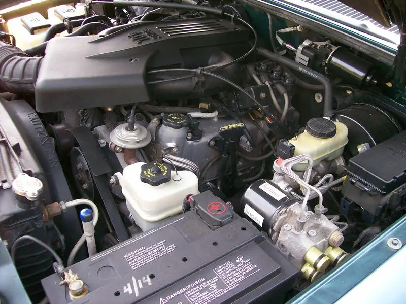

could it be the DPFE? black plastic box with small hoses attached to it. located on the driver's side valve cover. in this picture of my '97 Sport SOHC, it's behind the engine oil dipstick.
No, it's just a rubber "Y" that attaches the plastic tube that comes off the big air intake tube to two connectors under the front part of the intake manifold. I can read part of the number off the part. It's "XP904AG", the X is the letter/number I can't make out.
fuel vapor management valve Y?
I'm not familiar with your engine but from your description and location I suspect it connects the left and right ports in the intake manifold to the fuel vapor management valve. Mine looks a little different but is in about the same location as yours.
My upper hoses were heat shrunk onto the T fitting and impossible to remove without destroying them.
