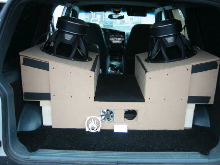

man are there ever a lot of different ways to do this
still in progres obviously and it doesn't show the amps which you sort of said you liked
oh yeah, one piece of advice- don't put components in the rear doors. i highly recommend putting both sets up front for better imaging. It sounds like you have a lot of great stuff already (wow are those alpine amps ever expensive) good luck with the install/finding someone to do it for you? that is what you said you wanted right? i wish i were closer to you.

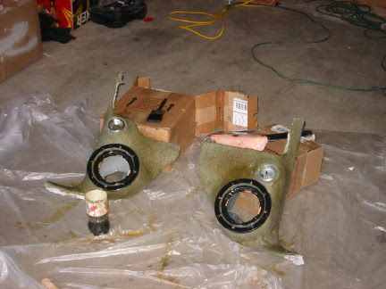

you also need some of these since you are gonna run both sets u pfront
Wow. Are those custom kick panels you made?? Did you do a write up on that?
i didn't reallydo a write-up or anything- if you want advice on how to build them i can help you some. also, i would be willing to make some for someone for the right price. I've made two sets now one for my truck and one for a blazer and both worked out real well.
here's a pic in construction
