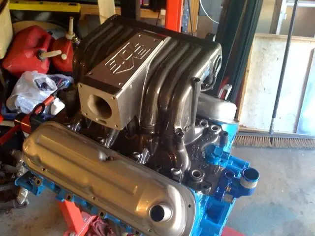

theres no point. our intake manifolds are comparable to those of a mustang cobra and alot of 5.0 mustang guys take intake manifolds and MAFs and throttle bodys from explorers

And as was stated before, check corral.net and eBay. Those guys LOVE the Explorer intake. It flows as well as the the Cobra/Lightning Tubular Intake without the HUGE price difference. It is the BEST FLOWING intake to come from Ford on a Windsor Engine.
