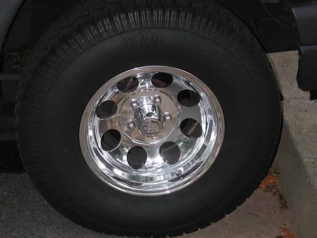

Stock wheel Backspacing for an explorer is 4.5, so figure a half inch more inside. Thats cutting it close, you won't be able to run larger tires. I run 3.25 backspacing, I don't rub at all on the inside, just the outside :)
Usually people look for 3.75, that is a pretty good in-between spot.
So what exactly are you trying to look for in a wheel? Chrome, silver, white, alloy, what?
I just went simple but nice.
