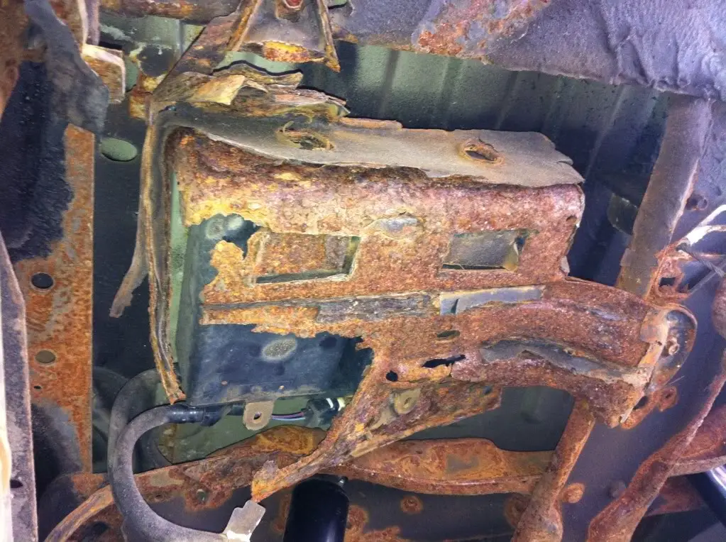

This is on the rear drivers side, you can see drivers side shock close to it. The mount is rusted almost completely off and im trying to identify what it is so i can get a new mount for it.
Thank you for any help. I cant find out what this is anywhere.

Carbon canister (Automotive Vapor Canister Filter).

Wow can def tell where you live , You only need the carbon canister if you have emission testing on a regular basis

Ok so info for any who search in the future, your best bet is to fab a bracket, or pay $142.00-$200.00 for the bracket.

Im just gonna try and zip tie the hell out of it to the frame or something. I cant believe the price of that part...
Agree, long zip ties are all you need to secure a light ABS canister.
Make sure the hoses are connected properly, otherwise you'll get a CEL.
