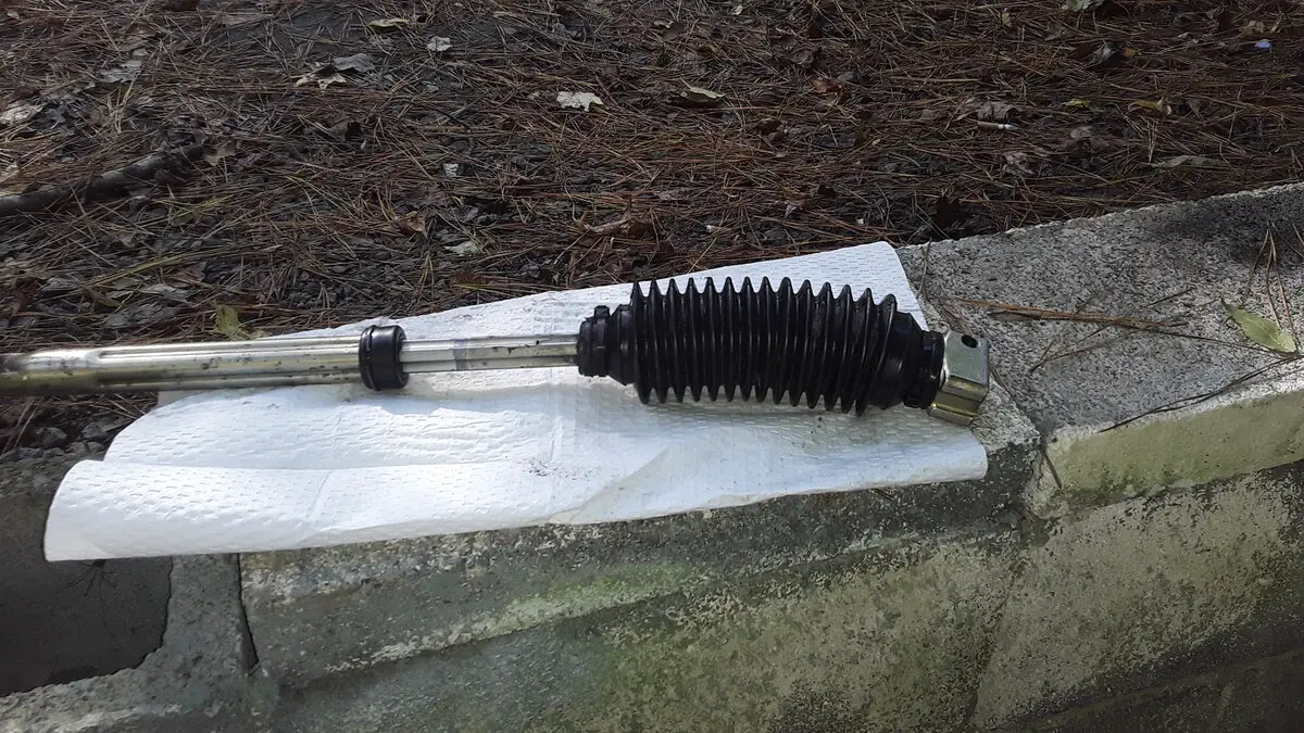

I just used some old electrical tape and wrapped it around the entire boot. It's been like that for 12 years without a problem.
Ok I got lucky
Or I'm just ocd about my maintenance
Looks good imo

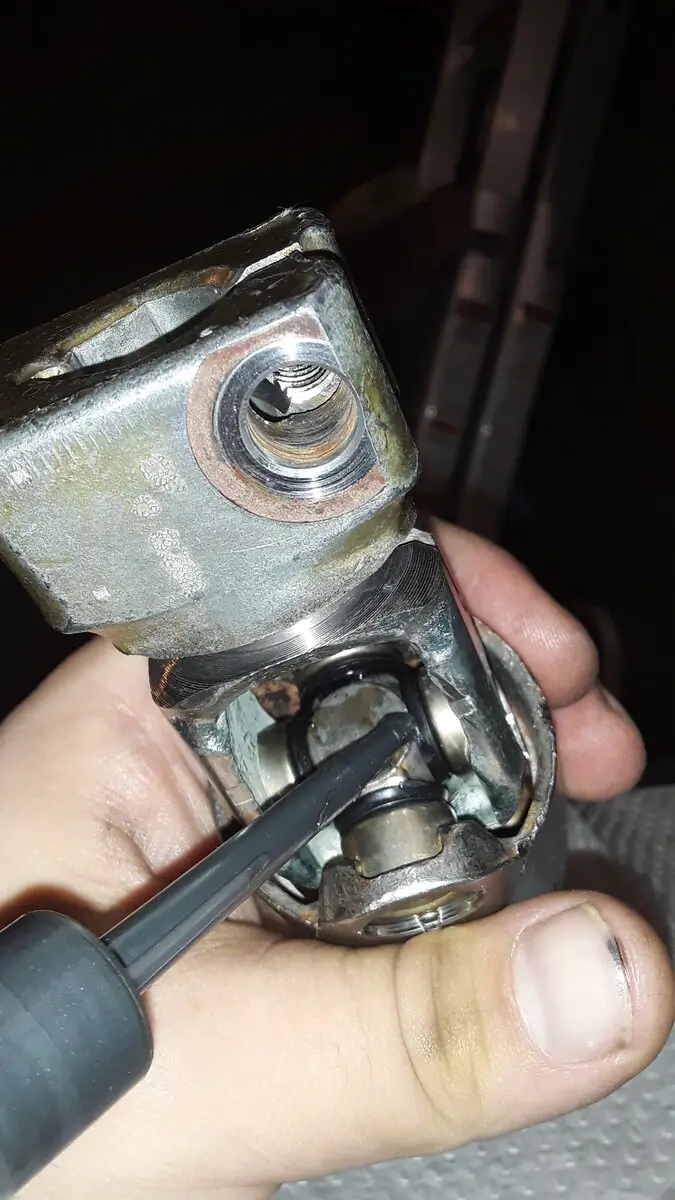

All I used is wd40 to clean
I used Molly grease ...what appears to be in there
A plastic syringe
A pick to carefully move the seal out of the way .....must be clean if yours isn't don't do it
Yes the syringe will pack the needle bearings
And reach the ball joint in between the u joints
I worked the grease in by moving the joint around
Then regressed
Finally I filled in between the u joints with grease
dorman 03670
I put the boot in hot water for heat
Stretch the boot and install
I'm hoping that this helps someone someday
A plastic syringe
Then regressed
Stretch the boot and install View attachment 323658View attachment 323659

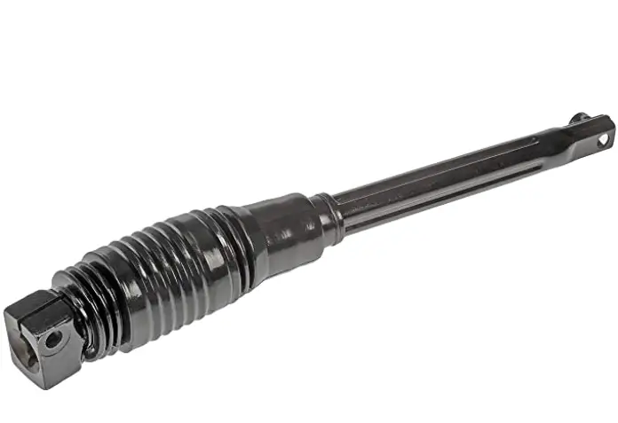

I did notice that the factory Ford shaft is still available for around $230-260 online, and Dorman makes a direct replacement (Dorman 425-368). Just FYI

Hmm, my shaft has a bit of looseness to it, not sure where it's loose yet. Looks like where the lower pinch bolt is.

Great find! After all these years, looks like Dorman finally stepped up to the plate and added this to their line up!
Just for long term thread info: (Dorman 425-368) is currently $170 @ Amazon
LINK: https://www.amazon.com/dp/B083V86TJ9/?tag=serious-20
