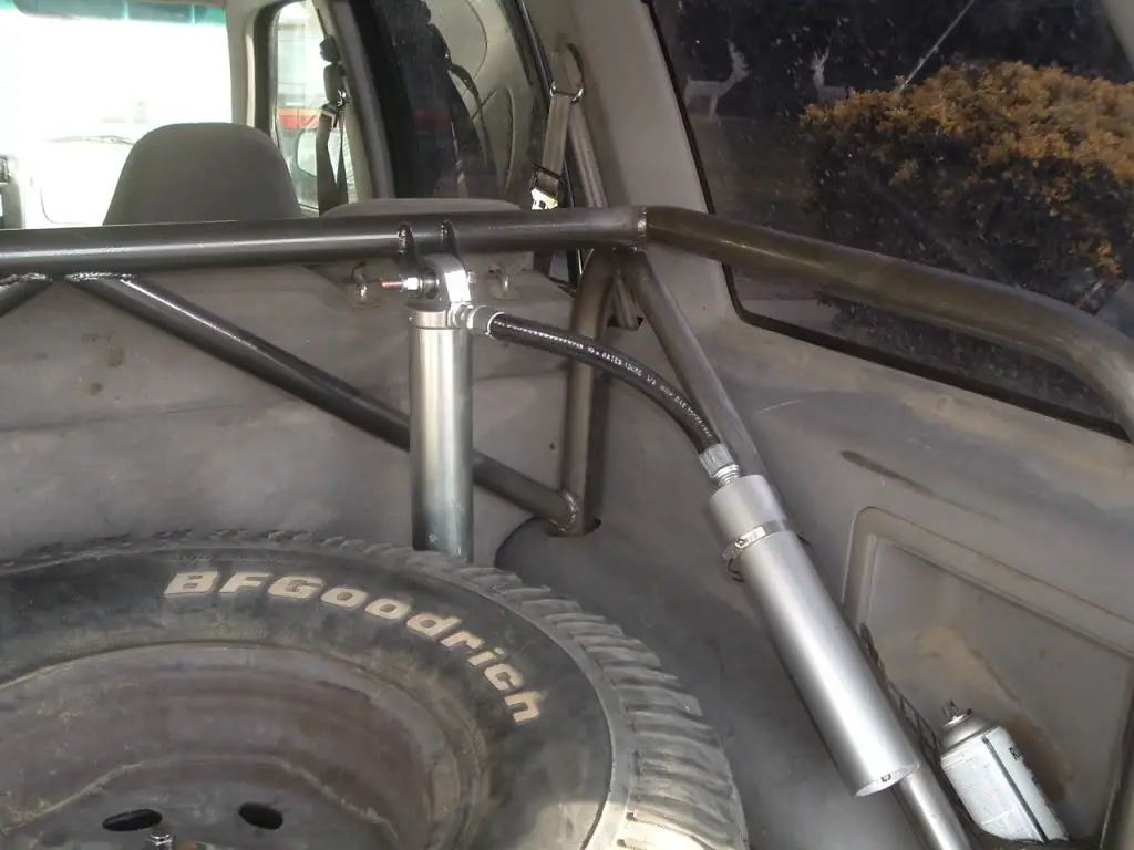

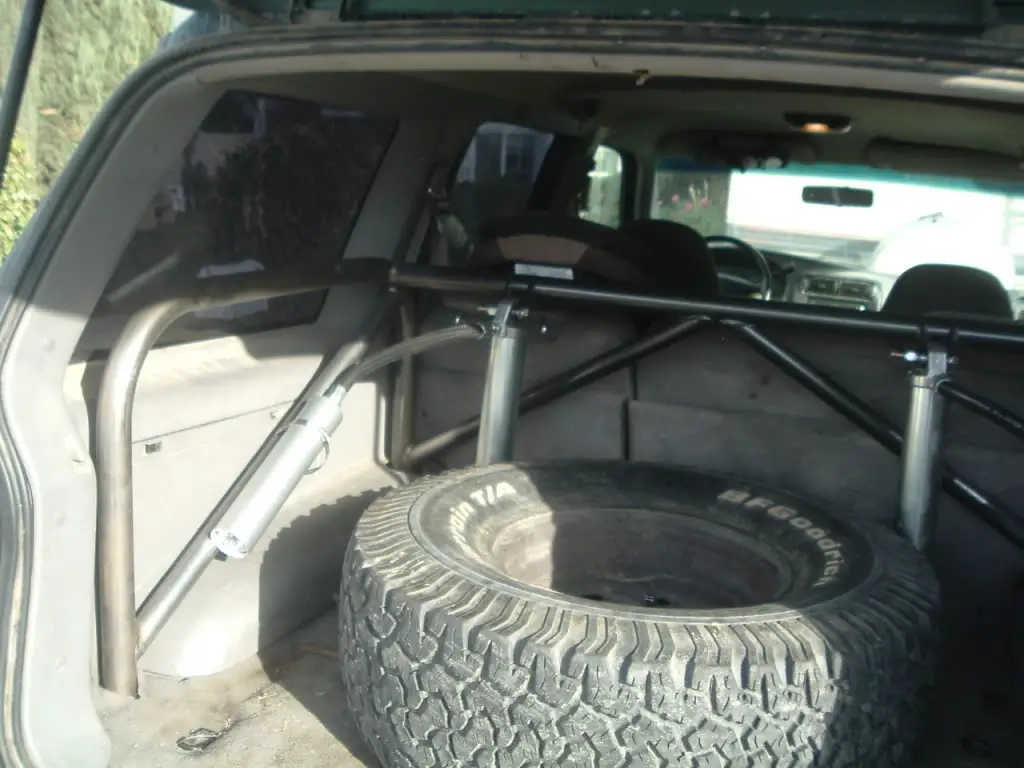

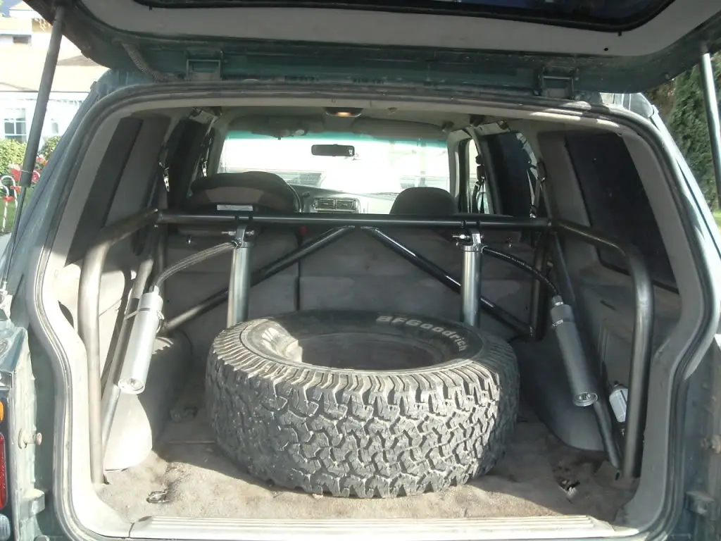

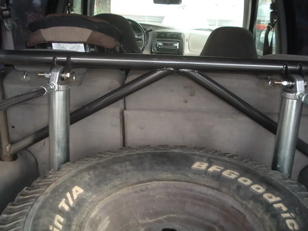

Added some bracing and support tubes. Will get better pics tonite. Was even able to reuse the carpet. Came out really really nice.
Those shocks are looong. Looks like a nice simple setup, can't wait to see it perform sometime.

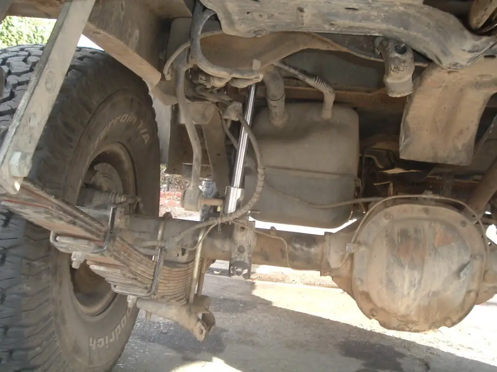

Looks like a sweet set up, are you gonna run air bumps? What up/down travel #'s are you aiming for?
Bumps are a must, but ran short on funds for now. but in the next few weeks ill run some radflo bumps for sure. Right now its 9.5" uptravel and 6" down. There is more down travel there for sure but we need to move the rear shackle hanger forward. We are gonna experiment a little with shackle lengths also. Good thing is at full bumps with this setup the leafs do not go into negative arch which is key to thier lasting awhile.

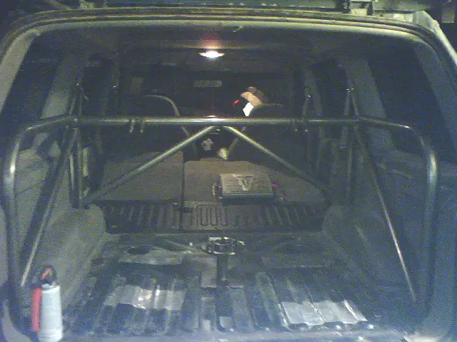

Trying to decode from here where to go. Of course a cage will be built next month, but after that...........
More than likely a junkyard 9" and rear glass, not 100% sure where to go though. Hmmmmmmmm decisions decisions....
Damn, that's big.
The rear hoop looks good. :thumbsup:
Thanks Colin. Yeah thats big, i have no clue how im going to keep my stock dash which was a key goal of mine. But anything over 4,000 lbs requires 2", and my explorer weighed 3,960 lbs when stock. So with added weight from cage, tires, and other things id need to shed about 400 pnds to be able to use 1 3/4.
