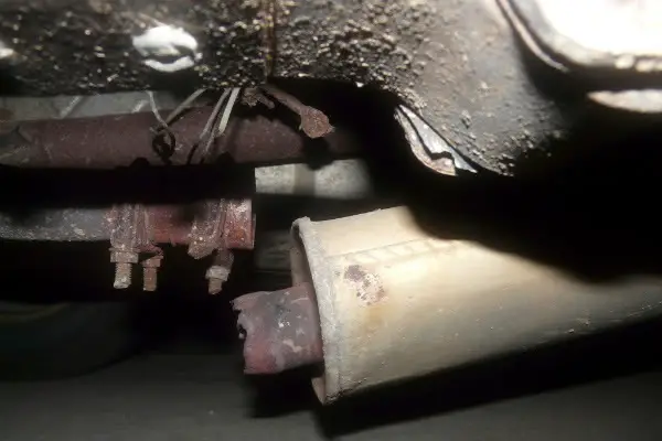

As strange as it seems, it appears to be this that was causing the codes.....
After puting the muffler back into the tail pipe, I haven't thrown a Check Engine light yet. It's the only thing I've done since I last got a CEL, and it didn't throw one on the 15 mile trip to work, nor the 20 mile trip around town at lunch. Since I've owned the truck that's the longest time without it throwing the 176 code.
All I can come up with is it's a back presure thing. That the exhaust has been loose (and it just slid right back into the tail pipe, nothing is "holding" it in there except gravity) and that it has been lowering the back presure because of the loosness and causing the O2 on the left/front to think the truck is running lean.??!??
Anyway, I don't think it's the actual connection in the pic that was causing the problem, I don't think the tail pipe section would make that much difference. But that section from the muffler to the cat has a connection that "piviots" and that also is somewhat loose. I think I got a better connection on it when I put the muffler back into the tailpipe and I think that has caused my codes to stop.... For now at least. I'll post up with more info if they come back. I'm going to have my exhaust done right and we'll see then for sure!

Ok, it's confirmed, it WAS the loose exhaust system that has been causing all my issues with CEL Code 176/136. It came loose again off roading in a dry creek bed thanks to a clearance issue and rouge exhaust removing rock.
Light came back and acted like it always used too. Spit, duct tape (not really), a clothes hanger, and a prayer has the exhaust back on until i can get it all fixed at a shop, but the light has not come back on for 400 miles.
Problem solved! :salute:
