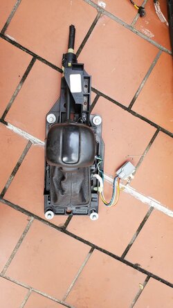

Hi all
Just got a console from local yard.
Have pui 2014 it is must be government level car. no hole no outside light no top sirens etc
But the plug at car dashboard has 12 cable when the plug comes from console has 44 cable lol. How the others make rear ac works and column shift to floor. I showed to body shop they all said NO 😃
There metal brackets at floor not fitting to console but has electronic cards and board on it ?
I give just install cigarette 12v thats it lol. (Even no power at 12v plugs from car ? ) Hard jobs seems to me very hard.
Edit : sunday afternoon gone lol /
-The socket from dashboard for piu was only 14 cable
socket on base sport console has more than 55 counts
- PIU original some cables come off hard to figure out i give try the new console socket
-Well only one of cigarette lighter worked 2 not woprking
all others things like rear ac lights did nt working
-Plugeed the parking sensor. unit straight from new console it is working (now have a spare lol will sell on ebay)
regular fuse box says compartone 1 fuse 9 for all 12v but seems different in this car how find other cigarette cables fuse (one dead after first worked out)
- shifter down to floor seems hard job so i give up on that and removed completly 4 bolt from console (now i have another spare for sell lol)
- Shifter gear hole is there searching how fill it saw some around forum that replaced extra 12v plugs.
will add done image column shifter looks cool to me so no. change at that,
How get power from 6 pin old socket seems black and red all has power want to use for 12v cigarette and one 110v 200w converter )
I GO TO AROUND ALL BUT SEEMS POSSIBLE FOR NEW BEE ALSO JOB ?
Thans for infos from forum,
And those who make all works like rear ac floor shifter etc
Seriously congrats :)
