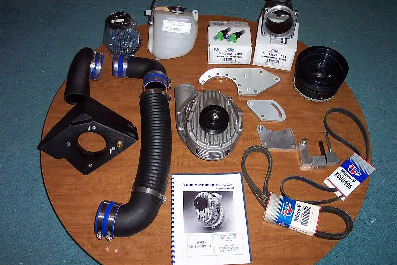

This is what I have.... Actually there is alot more. Just dont have pics right now.

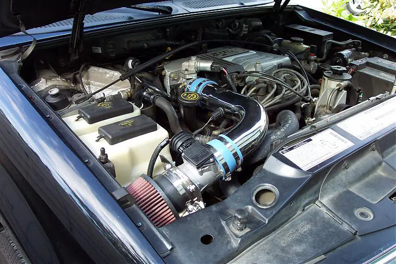

Another pic I found.......Gotta love the bed spread:D

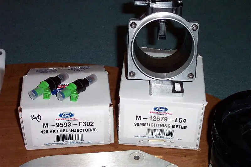

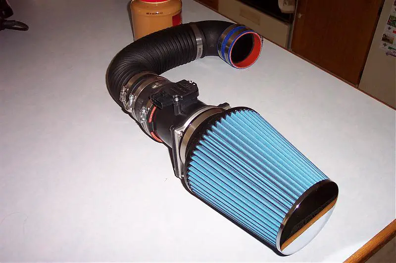

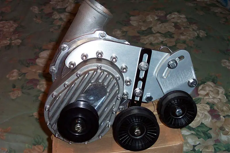

Found these too....
