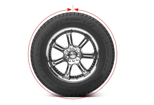

There is also a clutch pack in there. The quickest way to destroy a T case is diffrent size tires. They can have the all the same size on the tires and still be different because of air pressure or replacing one or tires at a time. Different tread depths. You have to check what is called stagger. Circumstances of each tire must be within 3/8 of an inch of each other.
@transman304 Hit me up if I'm wrong......we don't know, I don't think, which TC this is. AWD has a "viscous clutch" similar to a baby torque converter, with only fluid transmitting the force. The 4X4 TC, whether manually actuated only, or "automatically", has an electrically-operated clutch which is either engaged or disengaged, but is not designed to provide any "slip" like a manual transmission clutch. If it DOES begin to slip, definite problems will develop. imp
There is also a clutch pack in there. The quickest way to destroy a T case is diffrent size tires. They can have the all the same size on the tires and still be different because of air pressure or replacing one or tires at a time. Different tread depths. You have to check what is called stagger. Circumstances of each tire must be within 3/8 of an inch of each other.View attachment 95649
that is very interesting.I will take note
