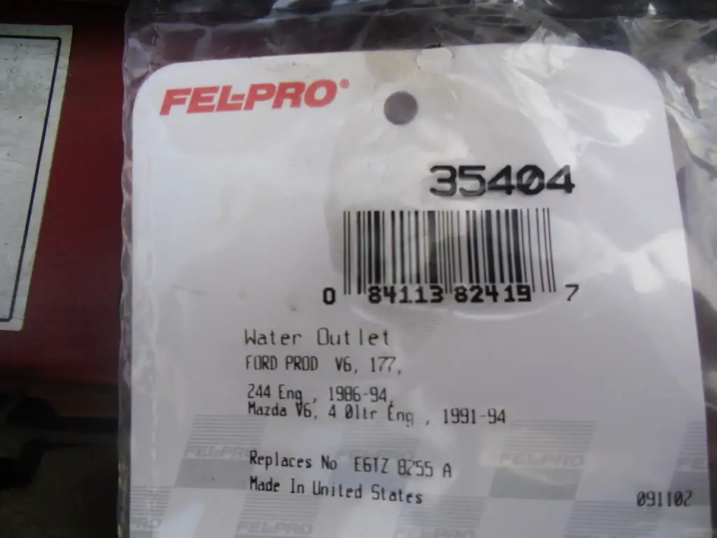

and an O-ring gasket:
DO NOT USE ANY GASKET MAKER.... it will cause issues later on (this is the big thing I found while searching) EDIT: Gasket maker instructions are noted in a comment below if you decide to use it.
