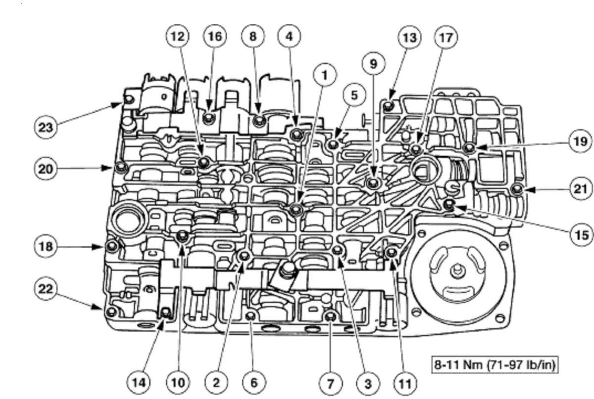

  3. While the pan is off, I want to make sure the valve body bolts are tightened properly. Is 96 in-lb correct for these bolts?

The pan 97-115 lb- in, filter 91-97 lb- in
@Pete Deering - Thanks. Re the pages you photographed, are they for the 5R55E in the 2WD, or in the 4WD, which one?
