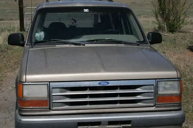

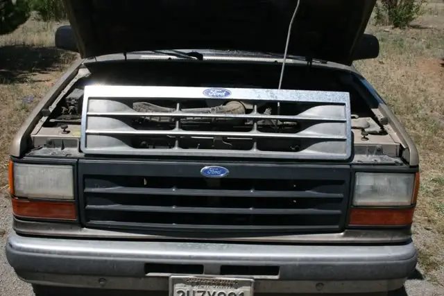

I don't like my chrome looking grill any more so I was able to get a grill set from a wrecked sport so I said sure lets do it.

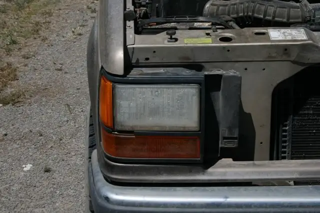

Here's the before shot.

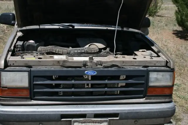

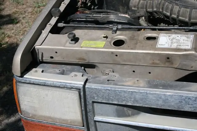

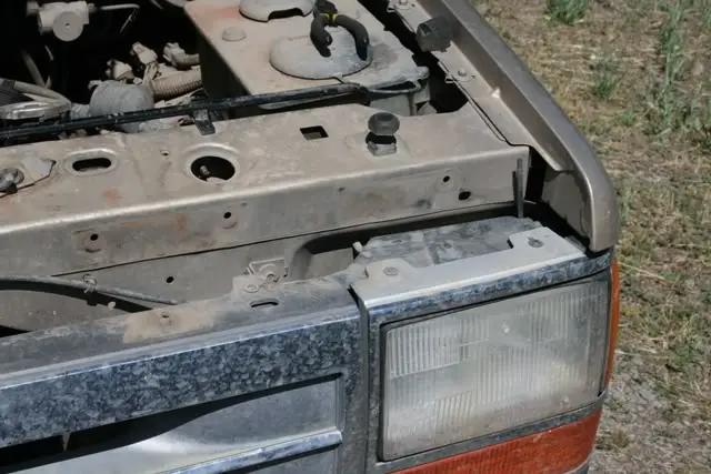

So to get started open up your hood and remove the plastic retainer screws all the ways across

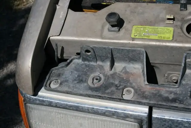

and remove the plastic valance thing to expose the screws holding the grill and the headlight bezels to the body
There are only two philips screws holding the grill to the body. Remove these.

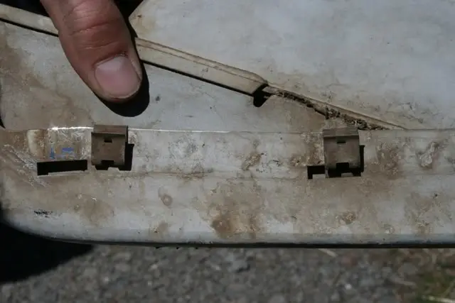

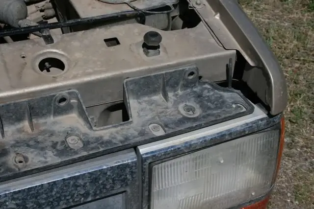

After the screws are removed, if you look down where the screws were you can see the clips that hold the grill on, mine were plastic on my original grill one was broke but this is what it should look like

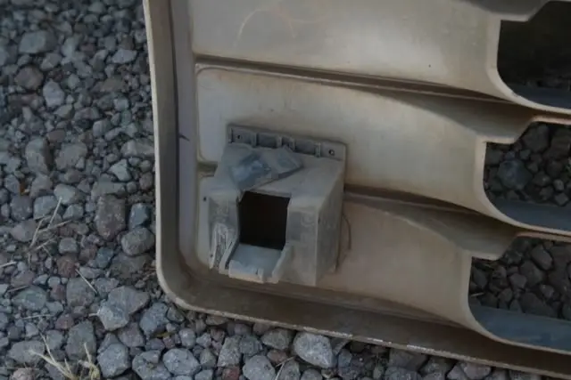

Here is my broke clip
I used a flat head screw driver to press the other clip down to help remove the grill with out breaking the other clip after this you should be at this point.

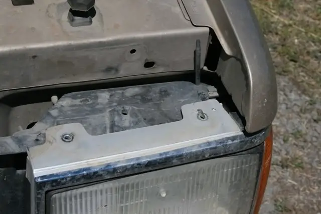

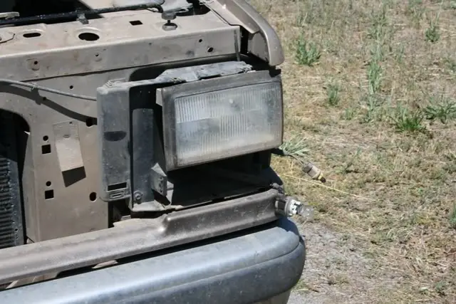

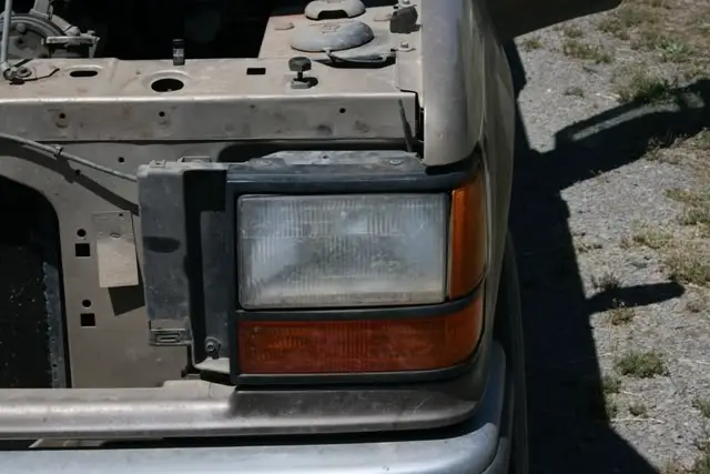

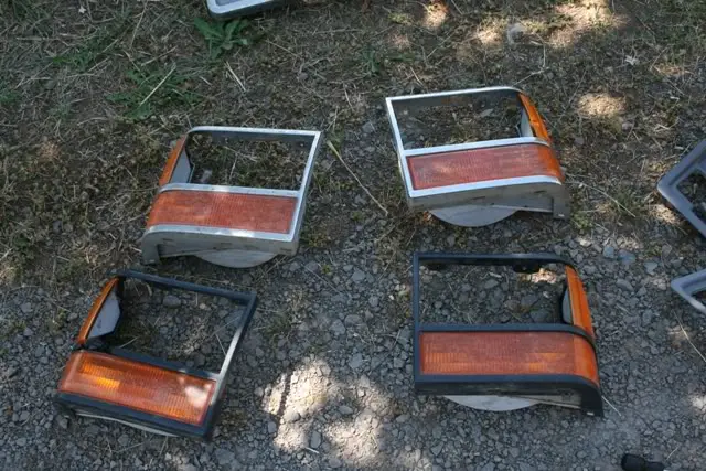

Now for the headlight bezels. As like the grill there are two screws in the top of the bezels on both sides.

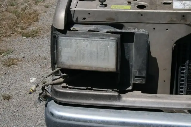

Now when you have the screws out this is where it gets somewhat more difficult there are three metal clips on the bottom of the bezels that make it a PITA to get the bezels off. Patience is key. Start working the bezel back and forth while pulling out if you pull from the bottom side you shouldn't have any issues breaking anything.

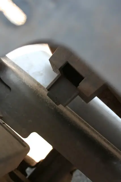

Here are the metal clips

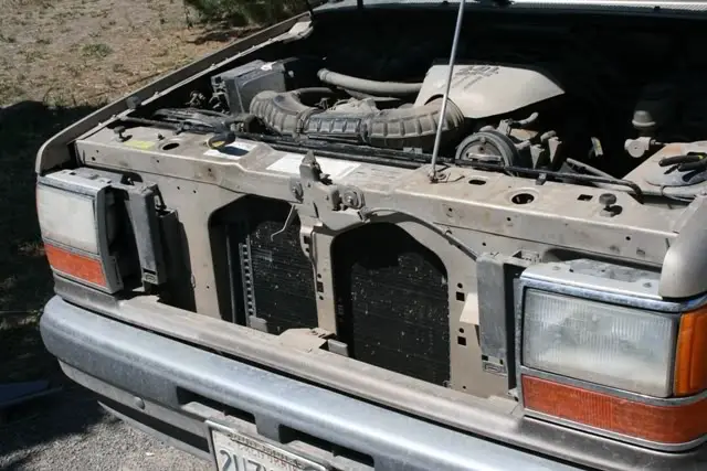

After you get the bezels off remove the light bulbs from the side marker

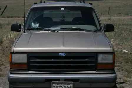

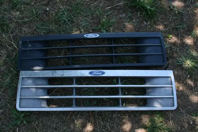

And the comparison

Idk the black pieces look cheap compared to the chrome. Well technically they WERE cheaper.
