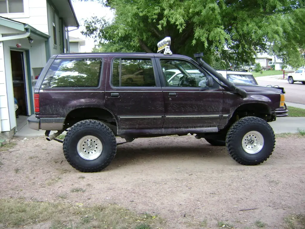

Here's my truck with a 3" body lift and 32's.
No rub and a nice tight fit. When i get around to putting my 4" suspension lift on i will swap on my 35's. In my opinion a 4" suspension lift looks silly with 32" tires, some trucks can pull it off but 33's look better on the 4" suspension lift.
