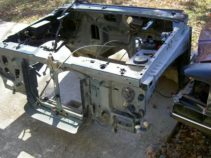

Their is a VIN tag on the radiator support also, did you find that one? It's a 2x3" plate riveted to the left side near the body mount I believe.
My 99 had the VIN stamped on both sides of the frame, along the side near the rear doors. I removed the OEM coating to refinish with Rust Encapsulator. Good luck,
Here's my old 93 front clip, see the VIN tag?

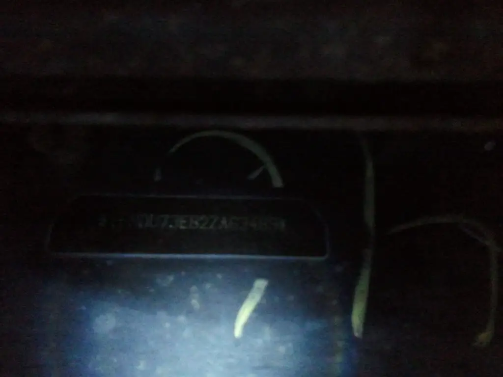

Okay - 2.5 hours later after scouring every inch I have found a tag.
Bearing in mind my truck is Right Hand drive UK spec, this picture was taken holding the camera down low (in line with the drivers door handle), and looking up to the side of the steel box-beam frame. It was all but invisible until I rubbed my glove over it, even though it was only lightly dusted with road grime. I did not quite expect to find it here based on other people talking about the top of the box-beam!! Its actually the top-[out]side of the box-beam. Dunno if this will help others out there. It had better do because it is all there is! Ah --- cannot seem to be able to attach a picture.
Good for you. If you can, please post a picture showing where along the frame it is.
Find a picture hosing site like Photobucket. Upload pictures to that kind of site, and then copy the image (IMG) location/tag to your posts here or anywhere online. Each picture you place on a hosting site has data with it, and you can right click on it or find the highlighted information for it, and pick the forum IMG data. Here's my car from my hosted pictures as example, hit quote and see what the data string looks like for a picture from photobucket.

Okay --- lets try this image thing again:
Here is what seems to be a VIN plate on the upper out-side of the right sub frame .... in line roughly with the front door handle!
Anyone know if this is the standard way Ford do it or is this the European 'Fix' / 're-stamp' that people are talking about?
Also, would be interested to know how this was attached? Is it glued or welded somehow?
