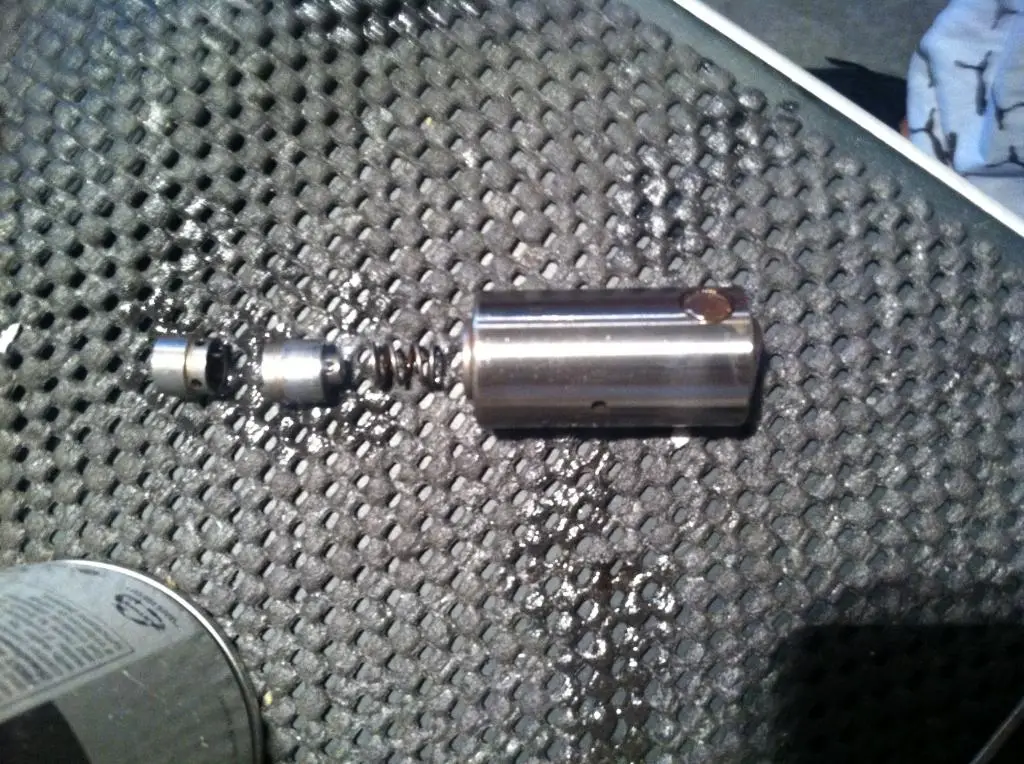

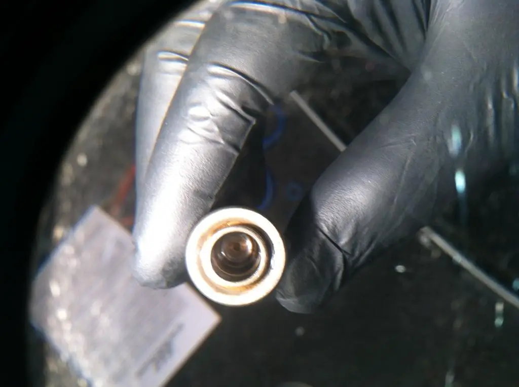

Are these three pieces the two pistons and spring?
or is the spring still inside after I take those two and spring out?
Also, my plastic cone pieces don't seem to snap on tightly. I played with some new lifters at the autoparts store (50$ each :eek:) and the plastic pieces seem to stay on a lot easier than my used ones.

Here ya go.really good thread and pictures ;)
http://www.explorerforum.com/forums/showthread.php?t=373261
