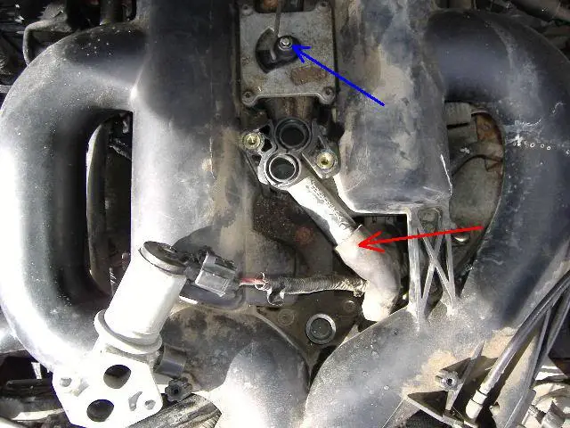

Hose disconnected
The hose at the red arrow was causing my P0171/P0174. I had knocked it loose doing some other work.
Does anyone know how to secure a replacement "hose" as referenced in DrDoom's picture? This is actually a Y connector that is part of the the IAC or Bypass airflow. Mine is torn to shreds. Local Ford dealer wants $213 for a replacement.
If no replacement choice other than dealer is out there, does anyone have a repair recommendation?
Not sure if this is obvious to you, but did you scour rockauto.com? If they don't have it, your options become slim.
As backups, I like to double check with Gates & Dorman's official website. Also check LMC Truck.
I would then direct my attention to junk yards. I couldn't believe how many Exs are in the PA jys these days.
If you have the OEM part number, search for it in Amazon. Some dealerships sell parts on there & you'll pretty much get the best stealership quote, but I'm not surprised by that insane price given these are very old models now.
If all else, get some generic auto hose and get to work with epoxy or electrical tape to get the Y. Whatever you do, please don't entertain that $213. Good luck.
I have looked far & wide. I checked on used parts, but nothing was available locally (already pulled). I found out that Ford only sells the connector as part of the upper intake assembly, so at least you get something for the money.
A buddy suggested epoxy to seal the hose. It seems to have worked. The good news, truck is running great and think this is behind me.
