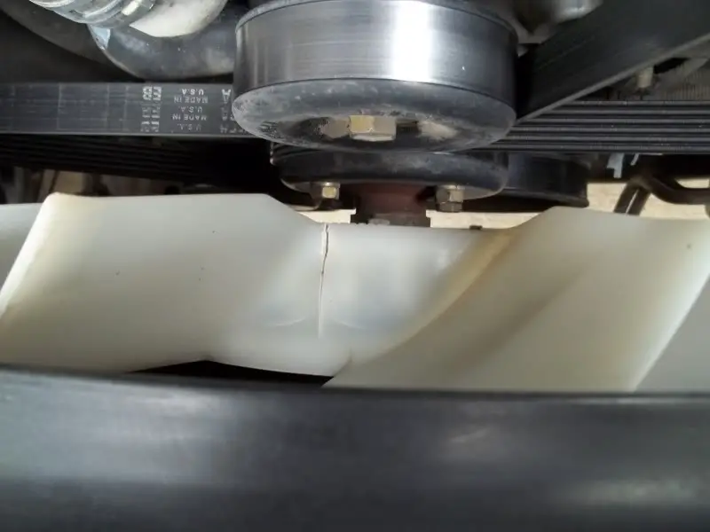

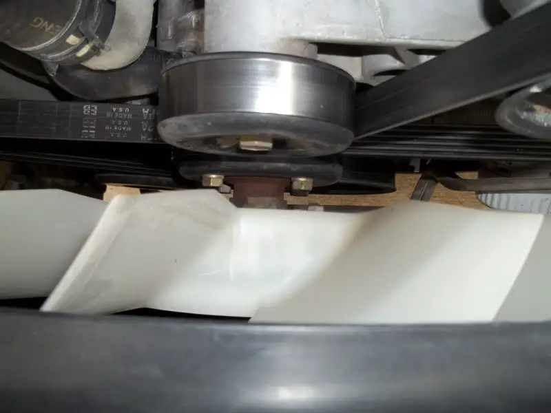

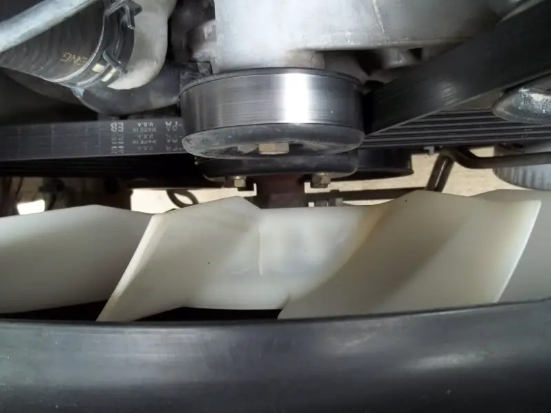

You are looking for stress fractures between the blades
All of em do this so look now!!!
looking between several sets of blades on a 2000 v8
OOOOPS!!!
even new ones out of the box appear to have white stress marks.
