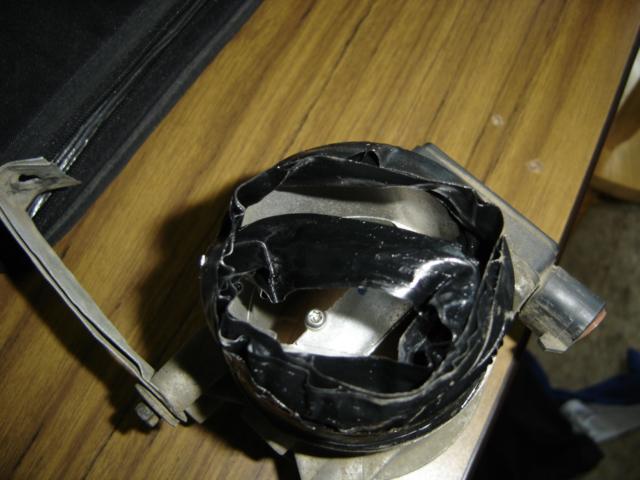

Well while reading over a thread about someone buying a MAFS i decided to have a look at the one i found and currently am using. To my discovery i think i might of found out why i still get the odd lag when i stepped on the gas.... Never use electrical tape as a bit of a bushing to attach soemthing with rubber sleeves....

Nope this was simply to make the outer diameter bigger for the coupling and clamps.
This is how i had it setup, i didnt want the rubber coupling to buckle from tightening too much so i wrapped some tape around it to make it bigger....
