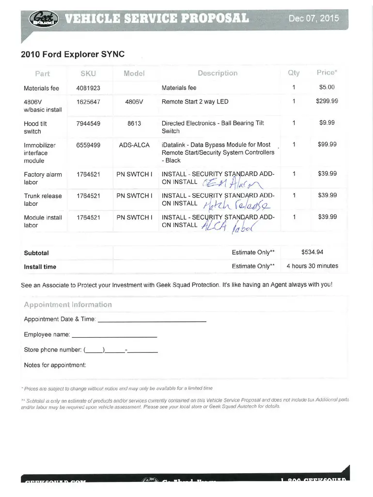

If it isn't on sale like it was last weekend, Best Buy isn't afraid to charge. They gave me a price of $534 for what was $239 a few days ago.

Here's what another Best Buy quoted yesterday:
[/URL]
According to the installer, the $299 price includes only basic installation. Car has an alarm? Add the first $40 extra. Want to unlock the rear gate? Add the second $40 extra. If you want a bypass module, you have to buy it for $100 then there's the third $40 extra charge if you want it installed. I'm surprised there's not a fourth $40 extra charge for that tilt switch.
