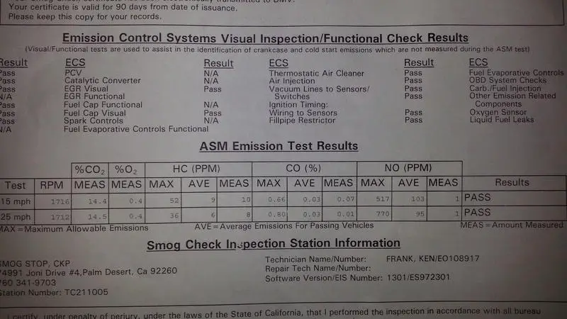

In other news the Ranger needed to get smogged this month but I had a rough idle problem but no trouble code. Checked all the plugs and sure enough the one closest to the firewall on the pass side (hardest one to get to of course) was completely missing the electrode. Replaced all plugs for good measure and checked the wires and all is good. Makes me wonder if the coil pack is bad...looks like a test is in order.
As for the smog test itself, passed with flying colors:

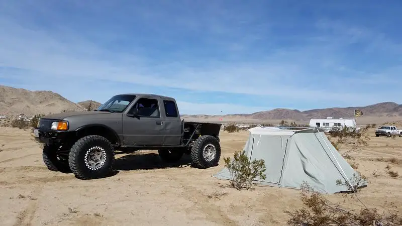

Took it to KOH so it was nice to have it and tool around the desert.

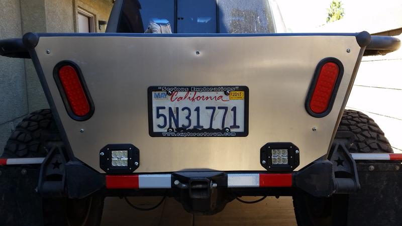

Got some flush mount LEDS for back up lights so I could actually see when I back up...im going to be blinding whoever is behind me. Had to make a whole new panel since I screwed up cutting the holes on the old one...no biggie.

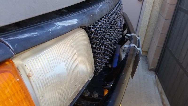

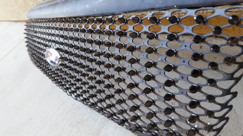

Also decorated my grill with 300 spikes and that's with skipping every other row. It would take 600+ to do every row:eek: The grill started out light as a feather, now it's got some weight to it.
