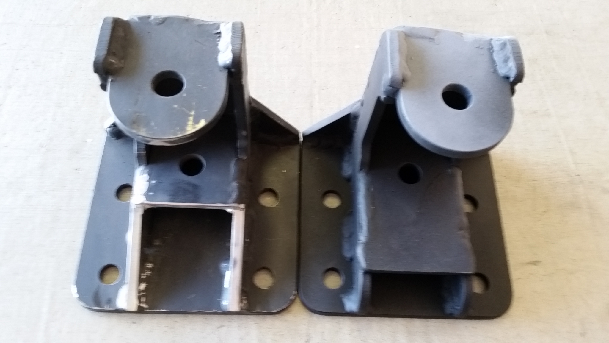

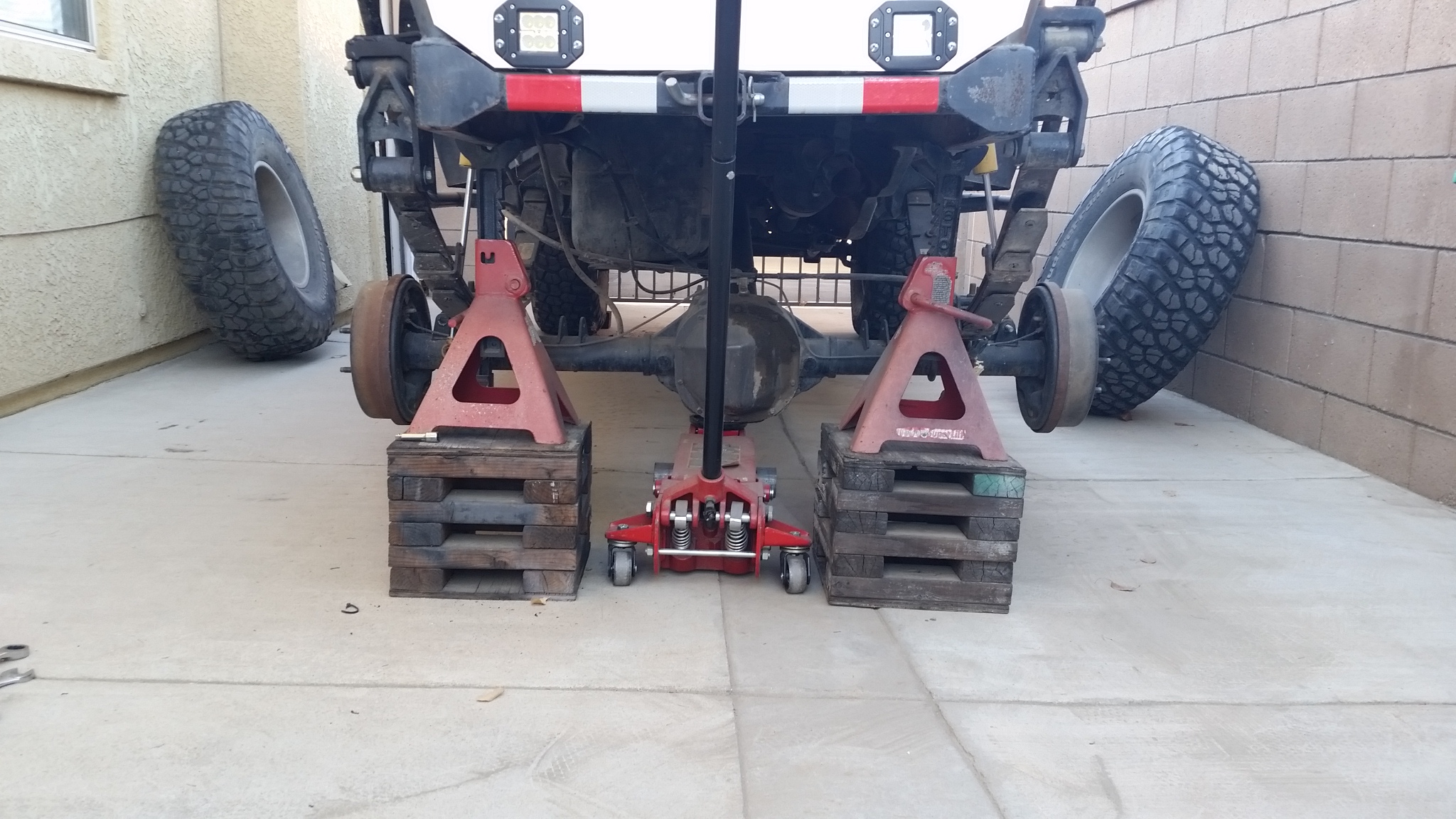

Installed some shackle hangers from Dresselhaus Fabworx...ok i made that up...got them from Rock Ranger to get a little lift at the rear end.
With my combo of Tacoma springs, oddball shackle hangers and shackles, it was a real crap shoot what height the rear suspension would end up at.
It was an inch or so low compared to the front so I just lived with it until Rock Ranger came up with a snazzy hanger design.
It would have been nice to just bolt these on but with most everything on my truck, that is not to be. Stock or even the 1/4 wall shackles that Matt offers work fine but I have 3/8 wall shackles and had interference problems so out came the grinder.
Almost hated to cut up Matt's fine work but it had to be done. In the end it turned out great now the truck sits level.
A few pics showing before and after hangar modifications.
Nice...:popcorn:...:)
Looks good Dave. I am going to modify them to be how you cut them so that they will clear shackles like yours in the future.
Thanks guys...i cut it a little close to the shackle bushing but I don't see it being a problem. Just need to get out and wheel it now...c' mon October!
