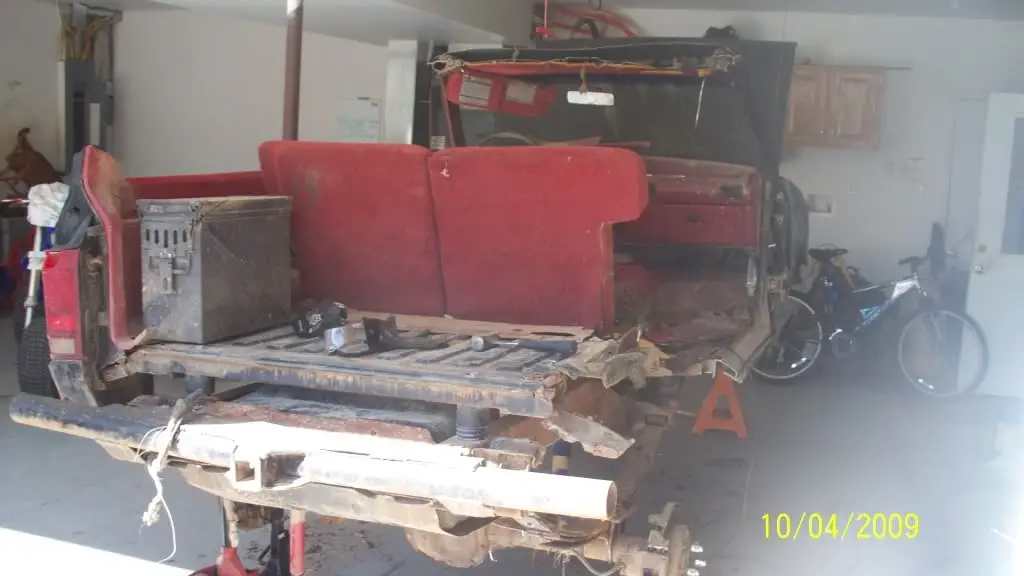

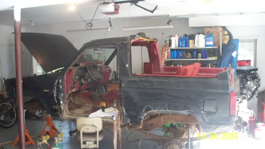

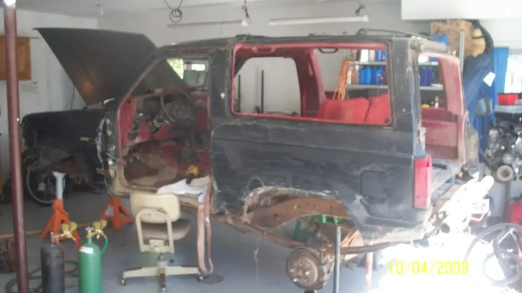

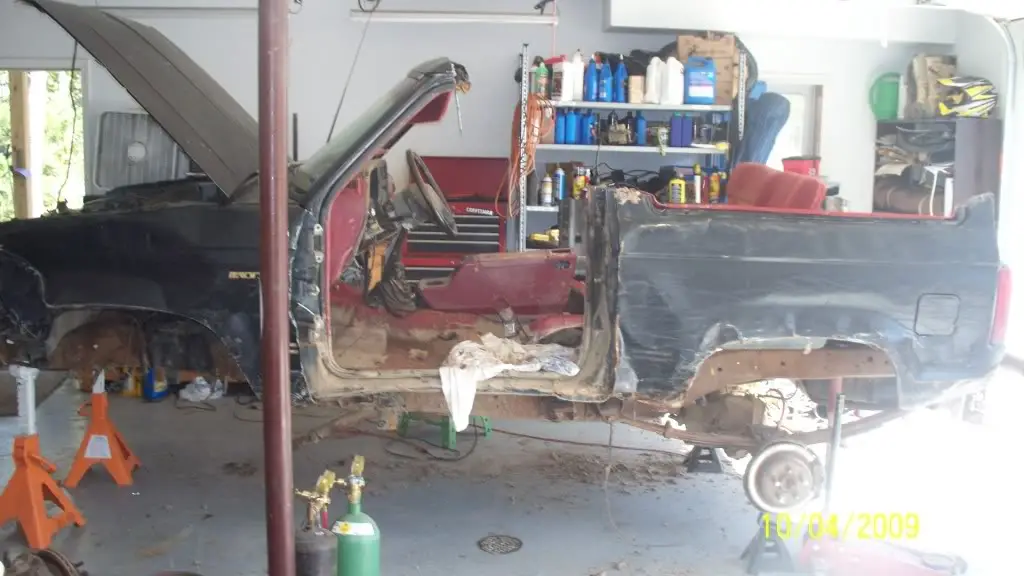

Well things are starting to wrap up on other projects and I miss my maroon SASd B2, but feel I'm ready for something with a little bit more occupant protection and less body work to mangle. So build thoughts and Ideas please share, this will take several months as money allows, have most parts accept DOM for cage.
Thought is to start with B2 frame, SAS it and custom cage it, but unsure of entire plan.

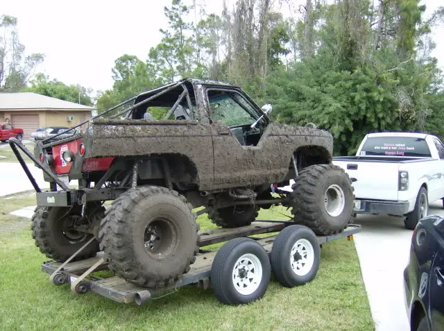

Those are some cool b2s, but i think im going for even less body work. It has a habit of getting tore up to easily around here.
