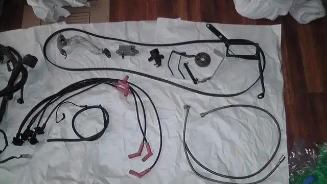

Got some goodies today thanks to USPS and UPS.
Can Anyone guess what's in the next pic?

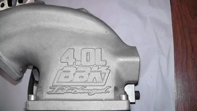

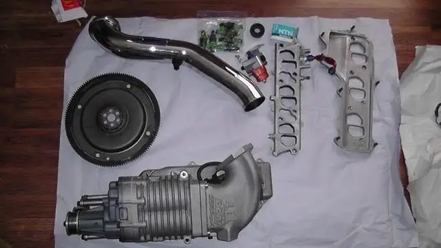

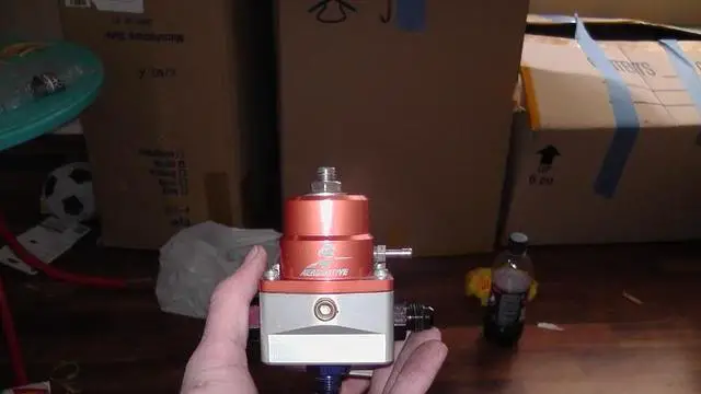

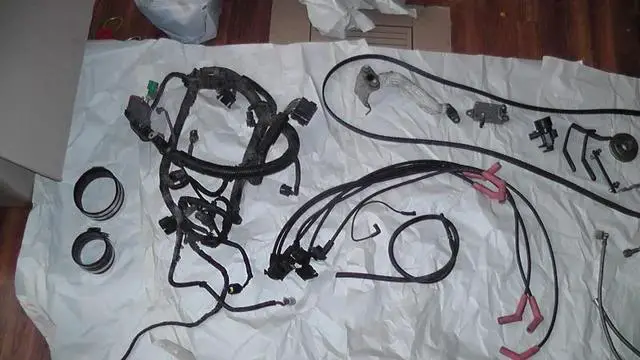

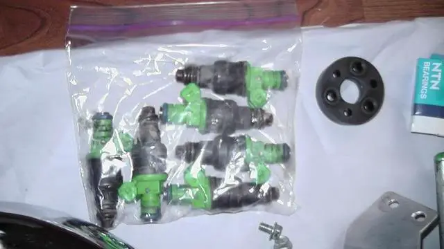

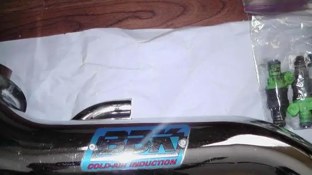

Its a full BBK Instacharger kit, with some upgrades. The guy who had it on his 95 Ranger trashed the BBK fuel controller and other crap, and put on a rising rate Aeromotive FPR and 42# Lightning injectors, then he had it tuned with a Predator tunable chip which he sent with the kit but I will not be using. He also rebuilt the sc about 5k miles ago.
I actually have a couple more things coming, a Walbro 255 LPH fuel pump, and a 90mm Lightning MAF, and I still need to order a wideband. But other than that I just need to bolt it on and have James write a tune.
