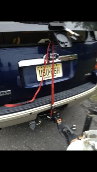

I can't imagine I'm the only person with this problem My class 2 receiver height is 21", my trailer coupler is 12" high. NOBODY offers a 1 1/4" hitch ball mount with a drop of more than 6 inches. E-trailer rep said 3 inches off level is okay, but that leaves the camper's back end 6-7 inches above the road. I'm not sure I trust that opinion. 1 1/4-to-2 inch adapter would work, but the manufacturer says NOT to use for towing, (also reduces hitch capacity by 50 %, according to manufacturer ), only for accessories like bike racks. It's an A-liner camper, weighing around 1600-1700 lbs. Vehicle towing rated at 3500 lbs.
Any advice would be appreciated.
