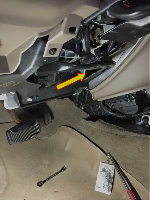

Well, second time for me in 5 years and 40k miles in between on my '05.
Interesting enough, my original replacement (which came from NAPA) was a reboxed OE unit. That gives me two failed OE units in about equal time. First one failed at 50k, second one failed at 95k.
Went back to NAPA, and this time the Dorman unit isn't a reboxed OE part, I'm hoping this means it's been beefed up.
Thought I'd post one thing on the top most fastener. If you remove the knee panel under the steering wheel, you can access the top screw with a long extension fairly easy. To put it back in, push the screw through some painters tape and fasten the tape to the socket. This will keep the screw from falling off.
