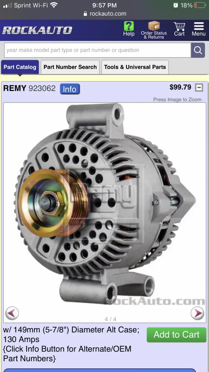

afternoon!
have another question. So I found a Remy alt on rockauto (923062), but the part number (f77u10316AA) on the back part on my regulator (?) doesn’t come up on the OEM list of that part on rockauto. So I did some more searching and found a regulator on eBay that was made to replace the original (VP4L2U10316AA). So would this alt

have another question. So I found a Remy alt on rockauto (923062), but the part number (f77u10316AA) on the back part on my regulator (?) doesn’t come up on the OEM list of that part on rockauto. So I did some more searching and found a regulator on eBay that was made to replace the original (VP4L2U10316AA). So would this alt not be a good fit for my truck?
thanks again
