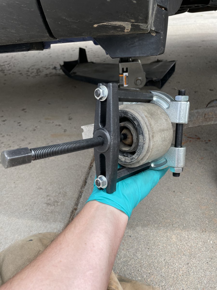

Alright, here is where I got started with the pics. You need a bearing puller like this;
Amazon product ASIN B09XCS9YSP
I bought this one for cheap on Amazon but parts stores should have one like this to rent. I know the Napa near me has them. Swing the arm to the rear of the wheel well and a et it up like this
Now all you need to do is turn the large screw to remove the old bushing and it will come off. Easy enough

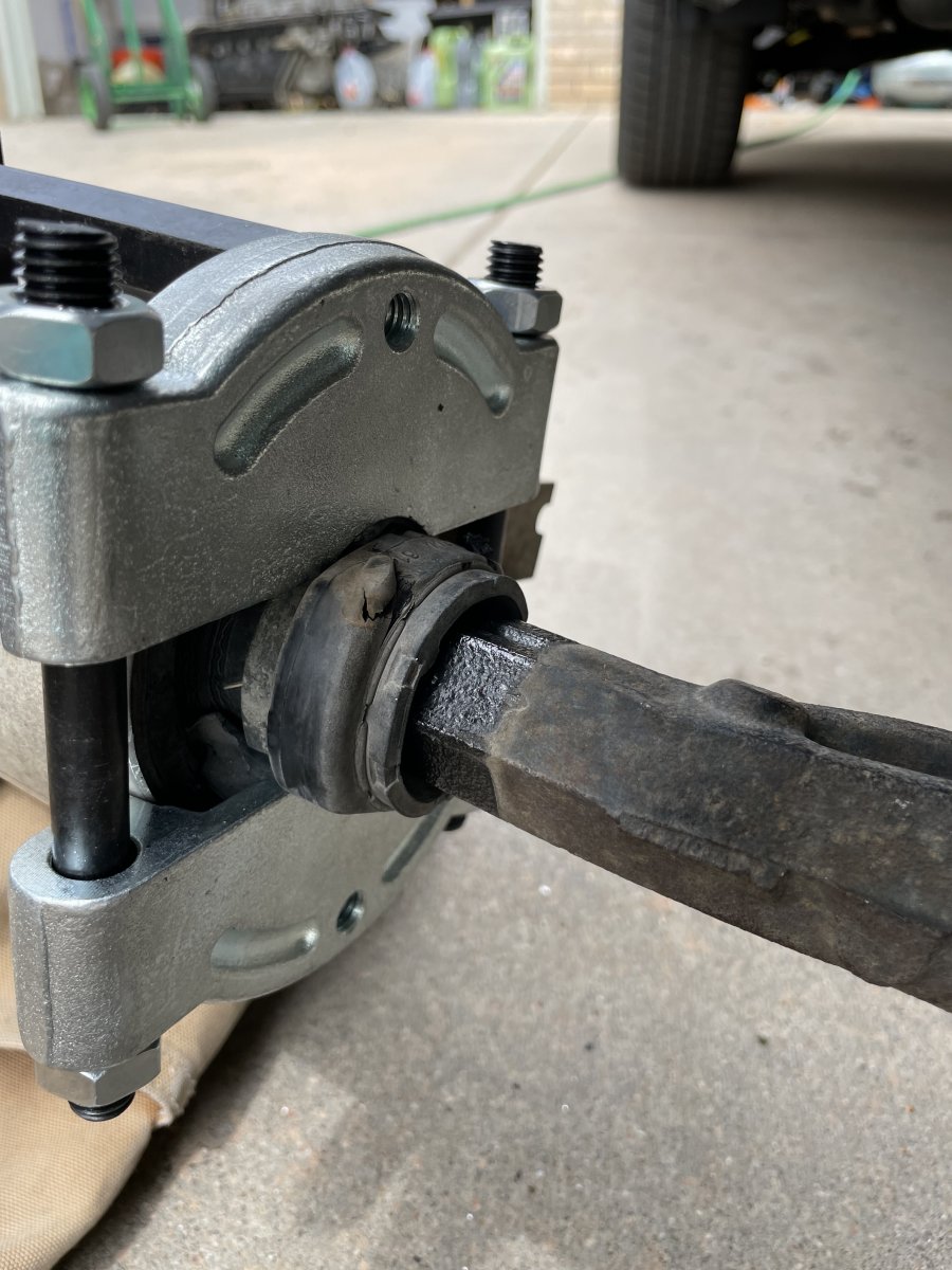

But wait… Depending on how bad your bushings are, it may come off in two pieces. Mine came off in one piece but I can definitely see how this could take one more pull to get the bushing completely off
Don’t panic though. Remove one piece at a time and keep going until all the pieces are off.

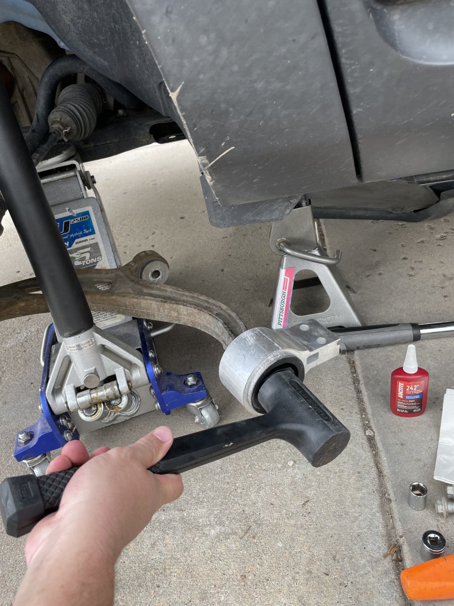

This is where you need either A) get creative like I did, or 2) just remove the ball joint nut and put the arm in a vise to beat the new bushing into the arm. Remember to pay attention to the position of the old bushing, or check the other side, so the new one goes back into approximately the same position
Check out this hillbilly setup
Floor jack was pushed all the way against and raised just enough to touch the subframe, creating a stable-ish place to support the arm.
Remember to lubricate the arm that the bushing slides on to. It doesn’t really matter how, as long as the lubricant is safe for use in rubber. I used a silicone/ceramic anti-seize paste.

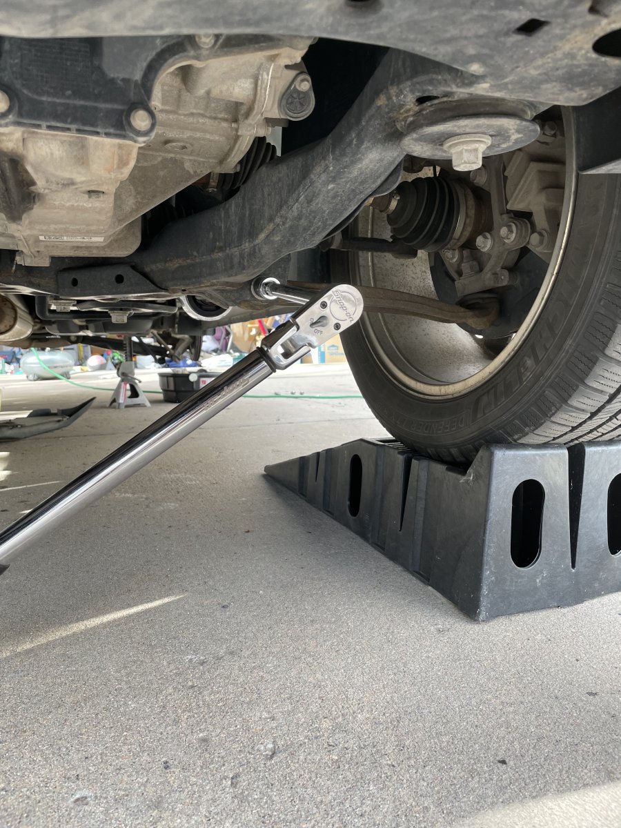

Once the bushing is installed, put the arm back on the subframe. You’ll need the dead blow hammer from the bushing install and a hefty pry bar to get the rear bushing seated correctly in the subframe. Make sure you clean the mounting bolts and apply a little blue loctite to the bolts. The rear bushing can be tightened as is, it doesn’t deflect with the ride height like the front bushing. You will need to put the wheel on and tighten the front bushing bolt properly with the vehicle at its ride height. I tightened the bolt by hand and then pulled forward onto some ramps. Then you can torque it down correctly.
Bolt torque specs:
Ball joint(if needed)- 150 lb/ft
Front bushing bolt- 140 lb/ft
Rear bushing- 75 lb/ft
