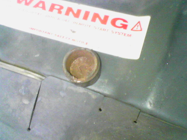

Welp, Got the u joints redone.
As you can see...it needed it. One of the caps on the rear started pouring out red dust as I was taking it out. When got it off, there were 2 pieces of bearings...everything else was dust. Glad I did not listen to Ford and replace slip yoke and bushing. Have the extension housing bushing and oil seal just in case now. Wanted to try and do it with just u-joints before I wasted $70 for the special tool and $180 for the yoke.
BTW that bushing remover installer from posts 11 & 18 are just installers. Not removers and installers as web site says. Went by Harbor Freight to get it, and it is just an installer.
Sorry they are fuzzy. Forgot my digital camera and only had my phone. Always goto my Dad's house as he has a shop bigger than his house. Makes it easy to work on your truck!
