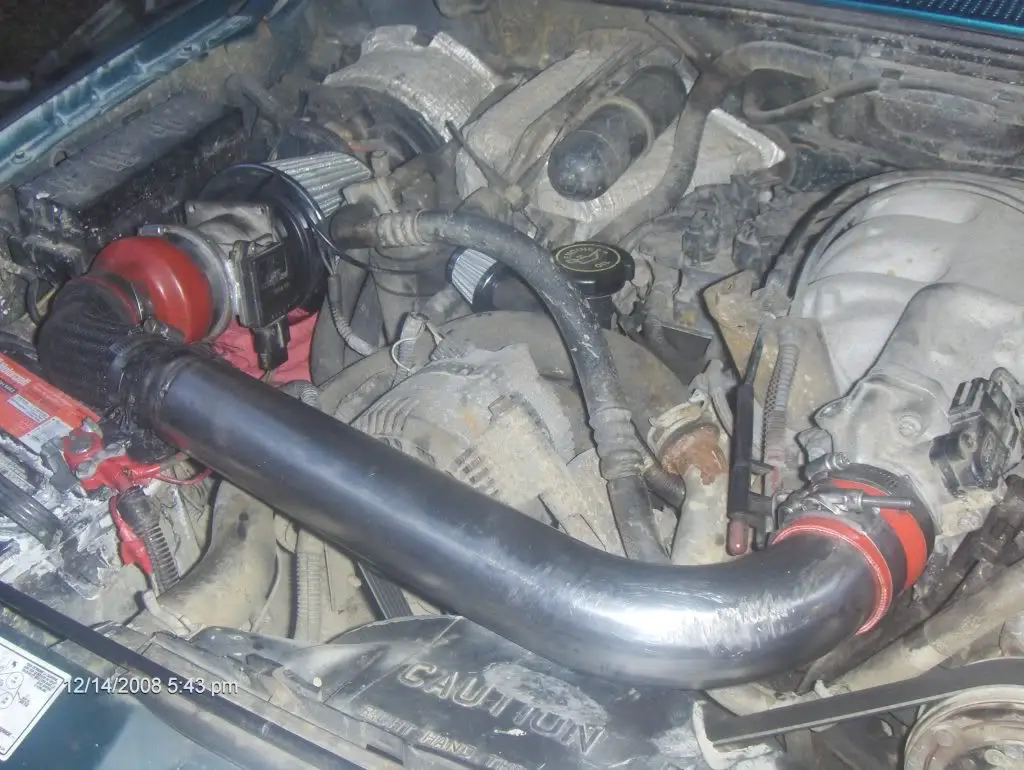

got board and put this together as well

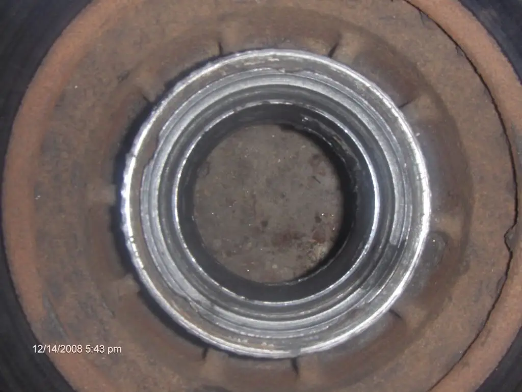

this is the back side of the rotor notice theres no bearing or a place to really put one and all the fins are missing from around the outside of the hole.
