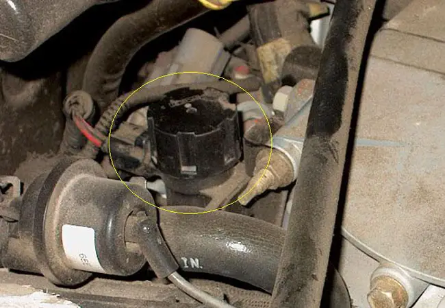

Someone correct me if I am wrong, but this is the DPFE on my '96 5.0:

According to the part numbers from Ford, that is an EGR Control Valve (part Number F-63Z-9J459-AA) for the '97 EX), and is different in appearance from the DPFE found on the left side of the block on the '96 4.0 Ltr.
I changed that part first as it was the least expensive at $22, and then changed the Position sensor-- $35--(attached to the EGR--and almost impossible to remove without the EGR--) along with the EGR-- $73. The only thing that I failed to change was the hoses (they appeared to be clean inside--and I forgot to get new ones).
I could very well be wrong--my wife says I usually am--but according to the ford dealer the part that you have pictured is not a DPFE. He brought one out and we both agreed that it didn't look like anything that was on the '97 V-8-- and according to his book was not what I needed.
Thanks for the reply and please correct me if I have made another mistake--I really need to figure this out.
No that's the EVR your model does not have the DPFE
