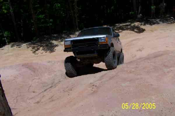

For a low cost alternative spring that works pretty well, try a late 70s F 150 spring. I'm runing a 77 SAS spring on mine, and they work pretty well. Lots of flex!
