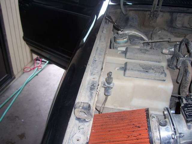

i doubt that, maybe maybe with the right tuning. is it a 5.0? mine is check it out, i have a custom intake, which is way less then a k&n system, and i still use a k&n filter, and i have a dual exhuast, flowmaster 40 series. search true dual and you will find my vid. if you do this right you can end up saving a pretty penny!
intake pic
look in the import section of your auto store. this is an adapter for a civic, then i re drilled the holes like this:
you will have to dremel out the gasket, but it was like 10 bucks i think...
as for exhaust:
im at work all night so i cant get pics up, but i will tomorrow evening. all it is is an "h" pipe where the last two cats are, and my two mufflers. then they turn down before the axle, the turn downs are connected to the last stock hangars b4 the axle, if you look you will see what i mean.
